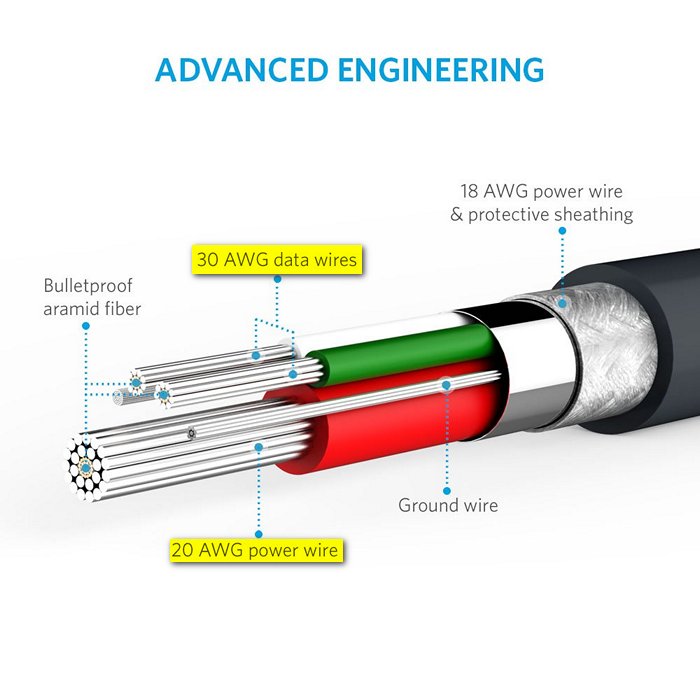

Today i notice a few differences. Smaller the number gauge thicker the cable is and that is what you want for power delivery
It says 20/30 s0 20 for power and the other for data. Anker i bought couple years back was Rs.400 and was 24 for power so thinner and 28 for data. Only thing that matters for cable quality is the wire gauge. Anker used to sell fancier cables with cloth insulation and charge more but the wire gauge was still 24/28 so i went with the cheaper variant. What is good with anker is the ports used, generally hold tight and don't get lose over time.

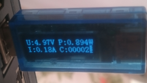

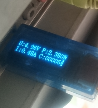

Here are my live findings using a charger doctor:
With Normal charging cable
In USB 2 port
In USB 3 port
With Fast charging cable
In USB 2 port
In USB 3 port
As seen there is a massive difference between these 2 cables when charging from USB 3 port.

Is your phone almost fully charged?
Otherwise I see no reason for the cable to restrict current to only 180mA.
In the last picture I can see 480mA. That is normal USB2 level current.
Discharge your phone quite a bit. If your battery charge level is more than 90%, the current consumption falls drastically.

What exactly is this fast charging cable?
It's still running 0.48A which is 480mA. Which is the max speed a USB2 device can pull from a usb port. The normal cable seems to be extremely crap quality which is why it's only pulling 180mA. Or there could be other conditions like @hotshot05 mentioned.
