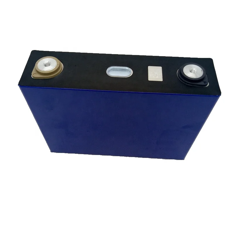

Battery importer in peenya 2019 price. Basically a 3.2v 100ah = 320whr battery costs 4750 inc gst.
And you would need 20 of them to get to 6 kWh
What is the name of the battery and does it come with any datasheets. How long is the warranty ?

I had a datasheet they sent it via whats app so I cant open it anymore but it was 2000cycles after which it still has 70% capacity. Basically it doesn't drop further. Lead acid would be 50% or below for the same charge cycles and keeps dropping till zero.
It was a prismatic cell the datasheet conveniently had the company name missing. But from physical look I can say its not from the top 5 chinese cell companies.
The exact price quoted was 3750+18% gst per cell. Obviously that's a 2019 price . But for 20 cells they would definitely give a discount.

I googled the model number found on the battery picture which the dealer shared and I got this.
