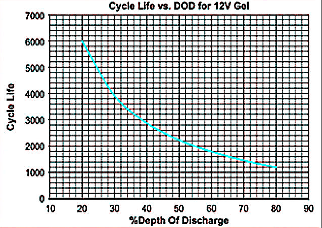

Exide own data says that gel batteries should not be discharged below 50%. While exide solatron is not mentioned in that list, it does weigh as much as a 5 year warranty c10 exide tall tubular solar battery, it weighs more then any lumninous battery with 5 year warranty. So it should last long, if you don't overcharge or discharge or operate in high temp environment.
that graph is on the back of the catalog so it can handle DOD less than 50%. Quite amazing to expect 1,000 cycles at 80% DOD
No info on charging rate is mentioned other than the usual. No warning about high charge rate.

Exide own data says that gel batteries should not be discharged below 50%. While exide solatron is not mentioned in that list, it does weigh as much as a 5 year warranty c10 exide tall tubular solar battery, it weighs more then any lumninous battery with 5 year warranty. So it should last long, if you don't overcharge or discharge or operate in high temp environment. But they do cost a lot more about 10k more then a 5 year warranty c10 exide solar battery
