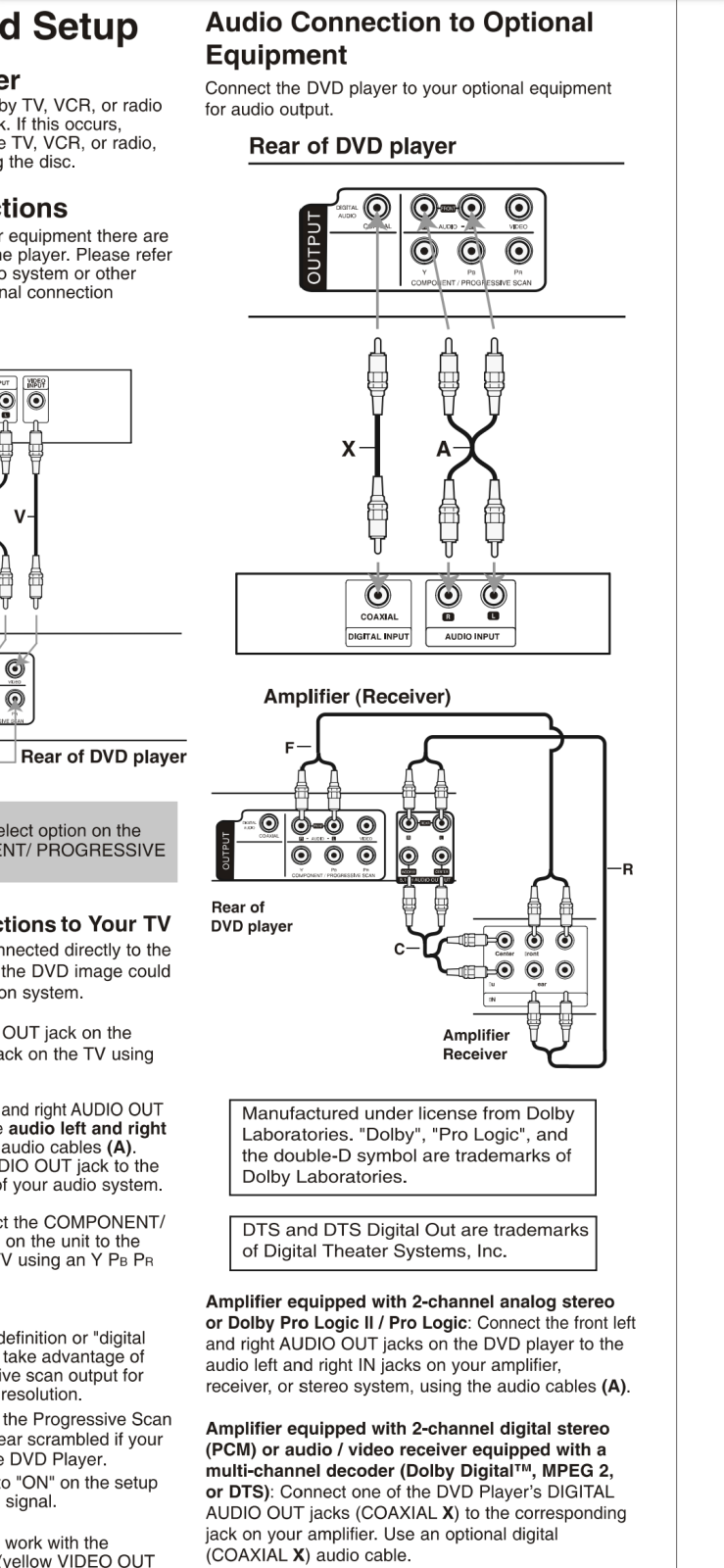

Just a FYI, coaxial audio outputs are not analog, you can't just connect them to RCA analog in. Coaxial outputs are still S/PDIF (digital bitstream), similar to optical toslink cables.
I suspected that... Still thought to give a try... Thanks for clearing it though.
