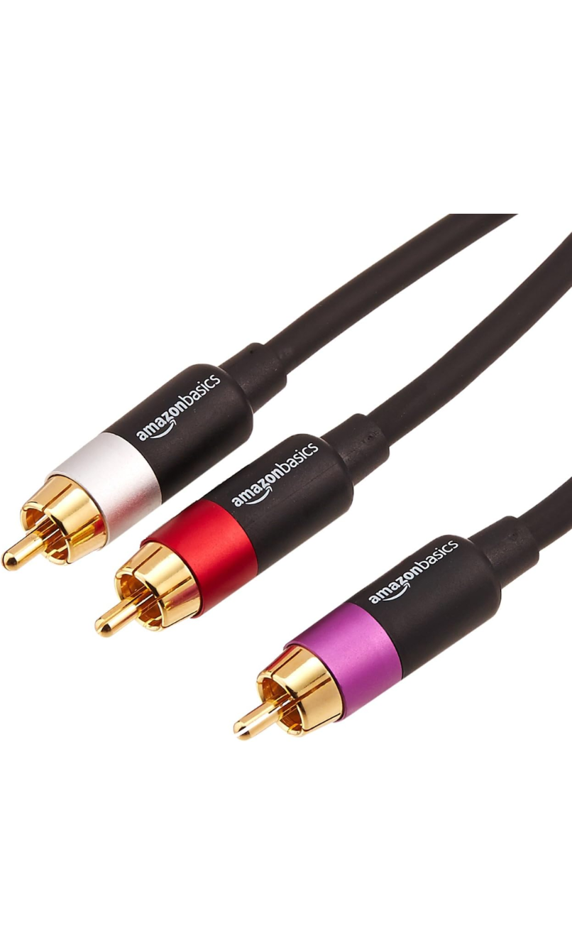

Actually I have just ordered this..
I am hoping to connect the coaxial audio out on dvd to the rca input on my amp...
Deal of the day: AmazonBasics 1-Male to 2-Male RCA Audio interconnects for DVD Player, Television - 4 feet, 1-Male to 2-Male (Black, Red, Purple, Silver) https://amzn.eu/d/185Nb06
If this doesn't work out then rca out on dvd player to rca in on amp

Just a FYI, coaxial audio outputs are not analog, you can't just connect them to RCA analog in. Coaxial outputs are still S/PDIF (digital bitstream), similar to optical toslink cables.
Reactions: Black_Hawk and JMak
I suspected that... Still thought to give a try... Thanks for clearing it though.
May replace the cable
