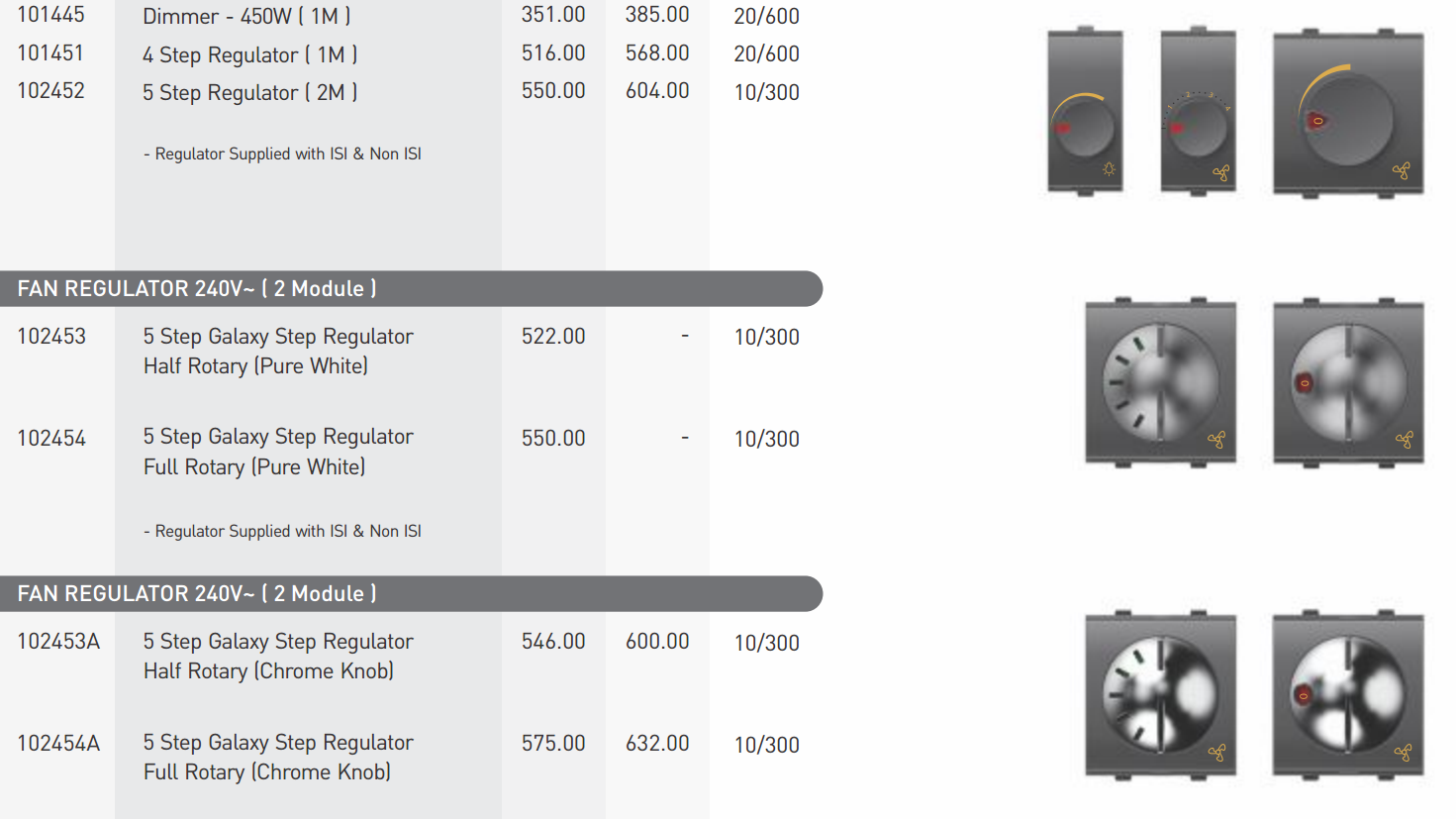

Above is the list of Goldmedal fan reguators.
Please note FULL ROTARY is recommended only.
Item 102454, 102454A
