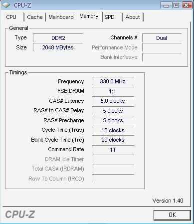

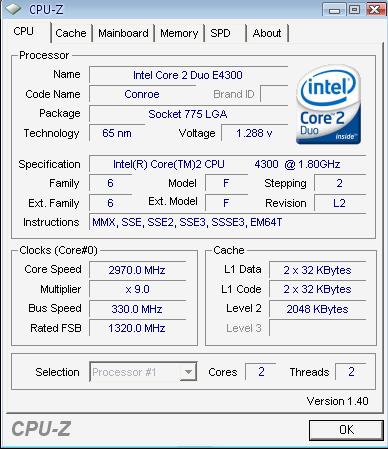

Hi ppl
This is my overclock results...I haven't changed the voltages kept the vcore at auto,Just the changed the FSB. to test the stability,i ran StressPrime 2004 ORTHOS for 2 hours without any errors.The SpeedFAN temperatures were around for Core#0 and #1 50-55 and for the CPU it was around 55-65 degree celsius while running stressprime.I'm using stok cooling with a 120mm FAN(PSU) and 80mm Rear FAN and a 120mm Front Fan.I haven't run any benchmarks yet...Will post the benchies soon.Any Improvements?
How do i make the FSB: DRAM Ratio 1:1?
Regards
PS:Any other soft for monitoring the CPU temp other than speedfan and core temp?

Congrats
very very nice results and temps for stock cooling with just 2 case fans..!! is the side panel of ur case open..? room airconditioned..? which case r u using..?
which mobo and RAM r u using? for running the RAM and FSB at 1:1, u wud have to bring down ur RAM clock or up ur FSB..
trying reducing the mem clock to 330 odd...also try tightening the RAM timings..
but, post more hardware info first..
Run the RAM at the same speed as FSB, and tighten the timings down.
Your not getting anymore performance by running it at 5:6 with such loose timings.

How do i tighten the RAM timings?
With Nvidia chipset you dont loose too much performance even if you run the ram out of sync. TO start with it has better memory controller than Intel counterpart and memory performance is much better.
Try to get it @ 800Mhz (400Mhz DDR) 4-4-4-15 2T.
So just tighten timings as much as you can. You are already at 400Mhz.
5-6-6 is just plain too loose.

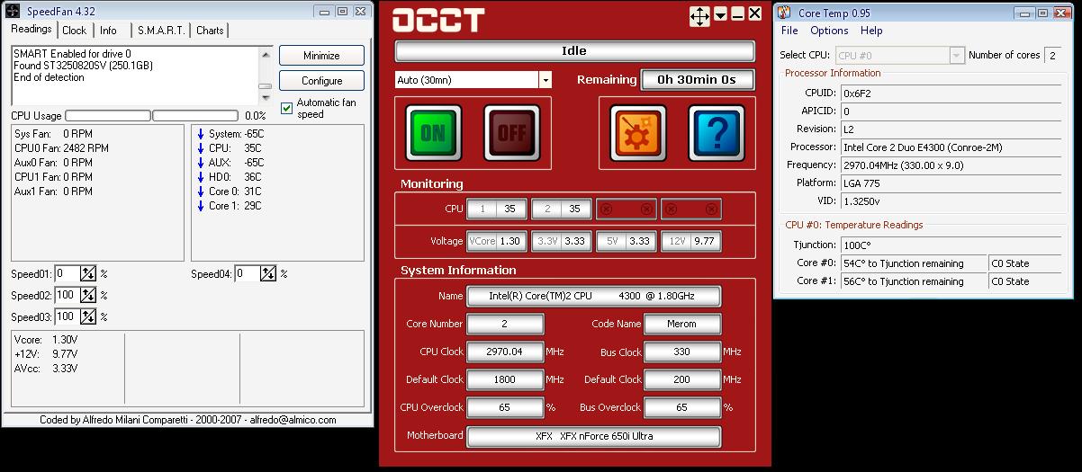

I'm running it as unlinked.Is it ok to increase the voltage to 2.0?Also i'm using 3 apps to monitor the temperatures-SpeedFAN,ntel Thermal Analysis Tool(Recognises my proccy as pentium M) and core temp. All show different temperatures...Intel's temp goes upto 65 degree celcius and speed FAN's max temp is around 58 deg cel...Which is showing the correct temp?
for some reason i have read enuf against tat hence dont believe its temp, in any case it doesnt run on my mobo, speedfan and coretemp are good, and will always show the same temp.
See the temperatures vary...Anyways do i change it from 1T to 2T?

^^ These are idle temps right?
Oh and bump the fsb a little more to 1333Mhz...
Yup its the temp on idle...Did u notice both the temperatures are different...Since i'm on Stock cooling on a good cabby with 80mm and 120mm(PSU) rear fans and one 120mm front fan for intake.I don't wanna overheat it...So just asking if my current overclock is good?or do i change it as u guys suggested(No offence but its new na..so don't wanna fry it)
Well, temps are pretty ok...
As far as I can figure, trust the core temp temps...
