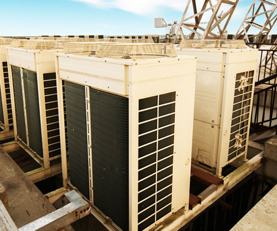

Look at VRV systems from Daikin for 24x7 operation. Modern albeit high-end homes in NCR are equipped with it these days. Needs ducting though so may need be very useful as an afterthought. Personally running 3 Daikin JTKJ units and even in 24x7 operation they do brilliantly well especially for maintaining the said temperature.

Don't know about VRV but I do know there are commercial whole building ACs that are designed to run like that, I think you'd find these in 5 star hotels etc. Not that it's practical for homes unless your building a big villa or perhaps preinstalled in some apartment complexes. Are VRV similar? I don't know the technical name for the system I described. I was simply hoping that they would manufacture a window AC for this kind of use.

I think vrf systems are still doable, chilled-water cooling is incredibly hard or even next-to-impossible to retrofit to an existing building.
At a basic level, central chilled water systems pump ice cold water to multiple floors of a building where blowers blow air over the chilled pipes and that's how the cooling works. The refrigerant remains in the room (could be the basement level) where the water is chilled, doesn't need to travel long distances.
A VRF is the same as a split in which it actually pumps the cooled refrigerant gas to the room where cooling is required and air blowing over the evaporator coil is cooled. VRFs are sometimes called multi-splits but that's simplifying it too much i guess.
https://en.wikipedia.org/wiki/Variable_refrigerant_flow
