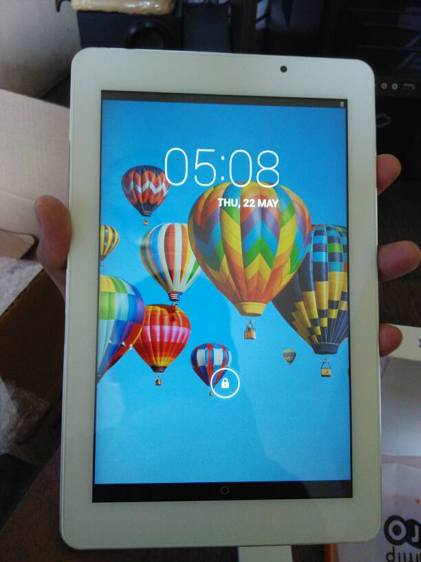

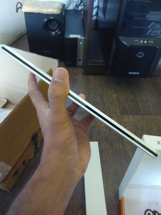

Just arrived. Pretty neat. Initial impressions of the display are very good. A bit glossy though.
