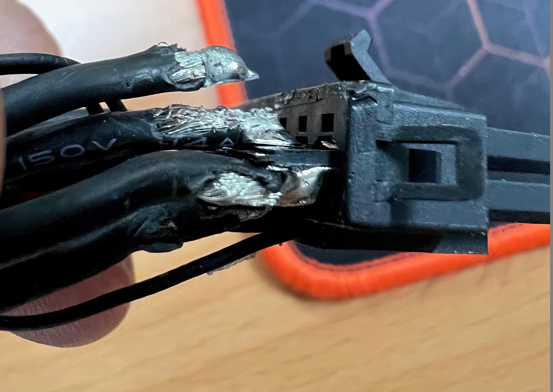

Don't hope. Open and check after half an hour of furmark or few hours of gamingAlways something with Nvidia. Was cheap thermal pads with 3xxx now this. Hopefully i dont face this issue.
If the connectors are burnt at the PSU side then there is a chance but so far all the connectors that has gone bad are at the gpu side so the fault is at 12VHPWR side. And also each pin of the 8 pin PCIe cables is rated for 7A, 7Ax3P=21A, 21Ax12v=252W, so there is ample room to draw more power as 8 pin connectors are generally restricred to 150w and PSU(Seasonic, EVGA and other quality ones) are known to provide up to 220w.Also could psu be at fault for burnouts like these?
All reports so far point to connector. Technically each PCIe lane from PSU is able to handle much more than 150WAlso could psu be at fault for burnouts like these?

Seems like it is an issue with the dongle that NVIDIA is supplying. Bad quality control on it.
That's a CPU bottleneck but that doesn't mean it won't give at least that much performance as last gen.Yup, a bit abstruse, but what I construe is the number of times RTX 4090 knocks door of Ryzen 5900x for data is beyond is the capacity of processor.
Issue is that the solder joints are not of good quality and hence prone to breaking/loosening when bended sideways.Seems like it is an issue with the dongle that NVIDIA is supplying. Bad quality control on it.
