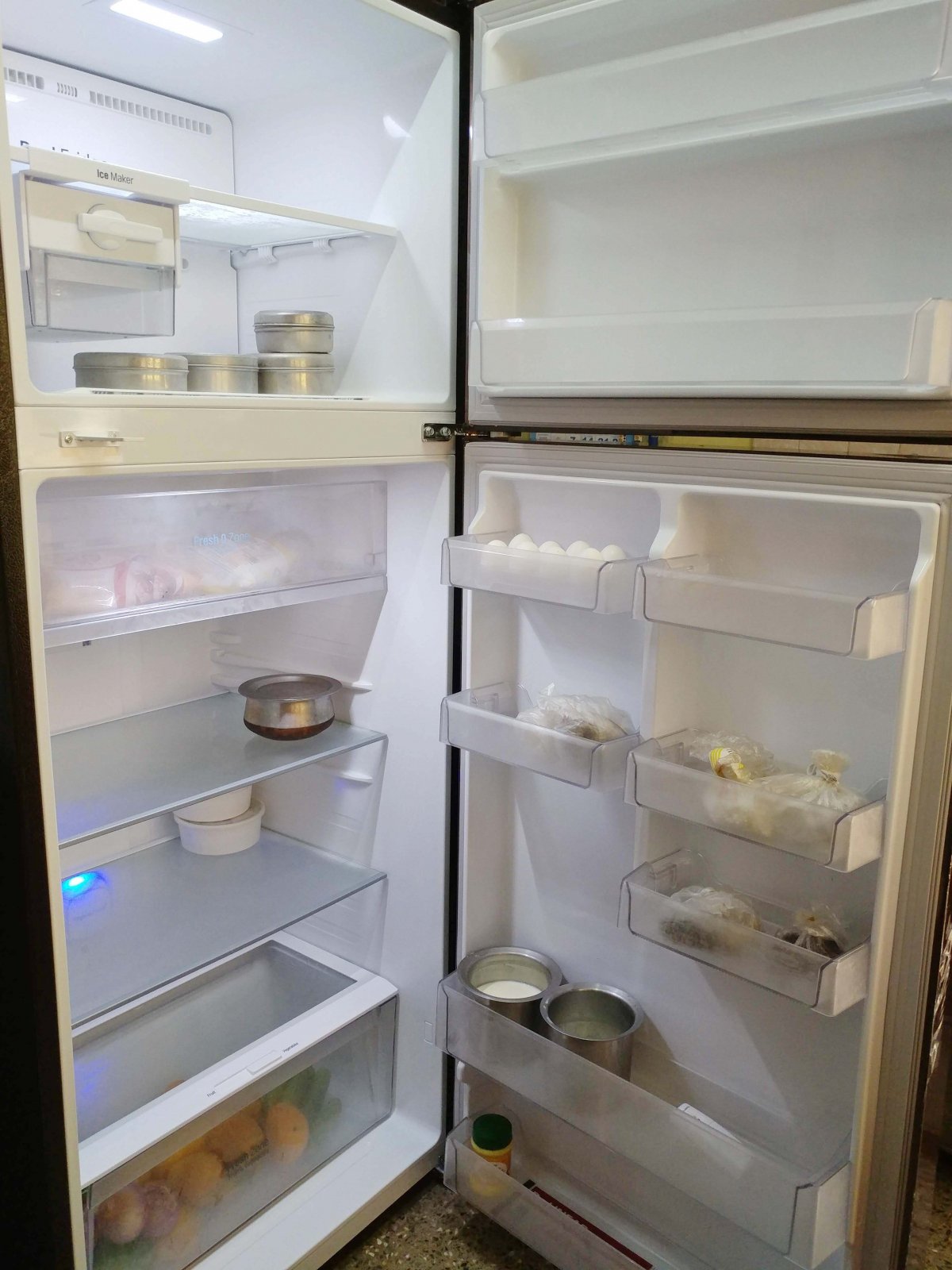

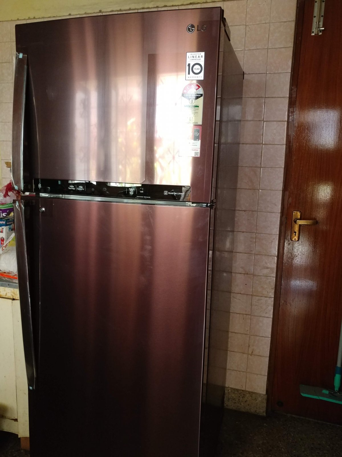

The new fridge arrived and been enjoying it for the past few days.
20190515_153416.jpg 20190516_133709.jpg 20190516_133802.jpg 20190519_215445.jpg 20190520_145829.jpg 20190519_190810.jpg
Got it from a LG brand store on the outskirts of the city. With the old fridge exchange it worked out to 55k. The Amber steel is more of a darker brown colour than a lighter shiny copper colour. Well, it varies it looks brighter in more shiny light. I like the look.

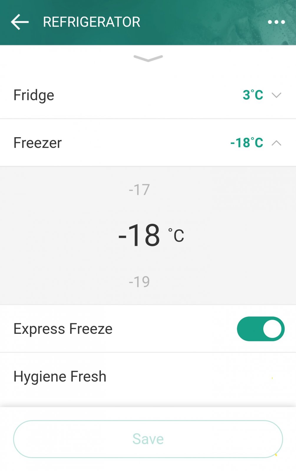

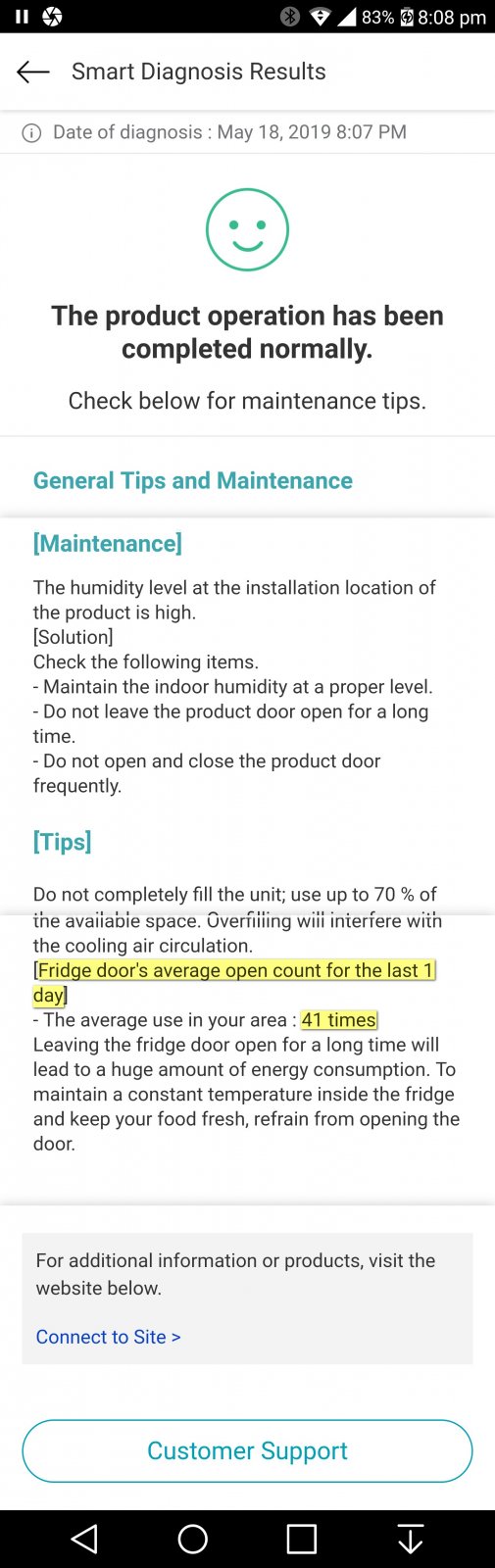

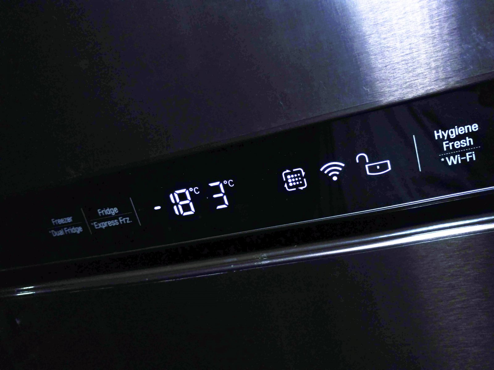

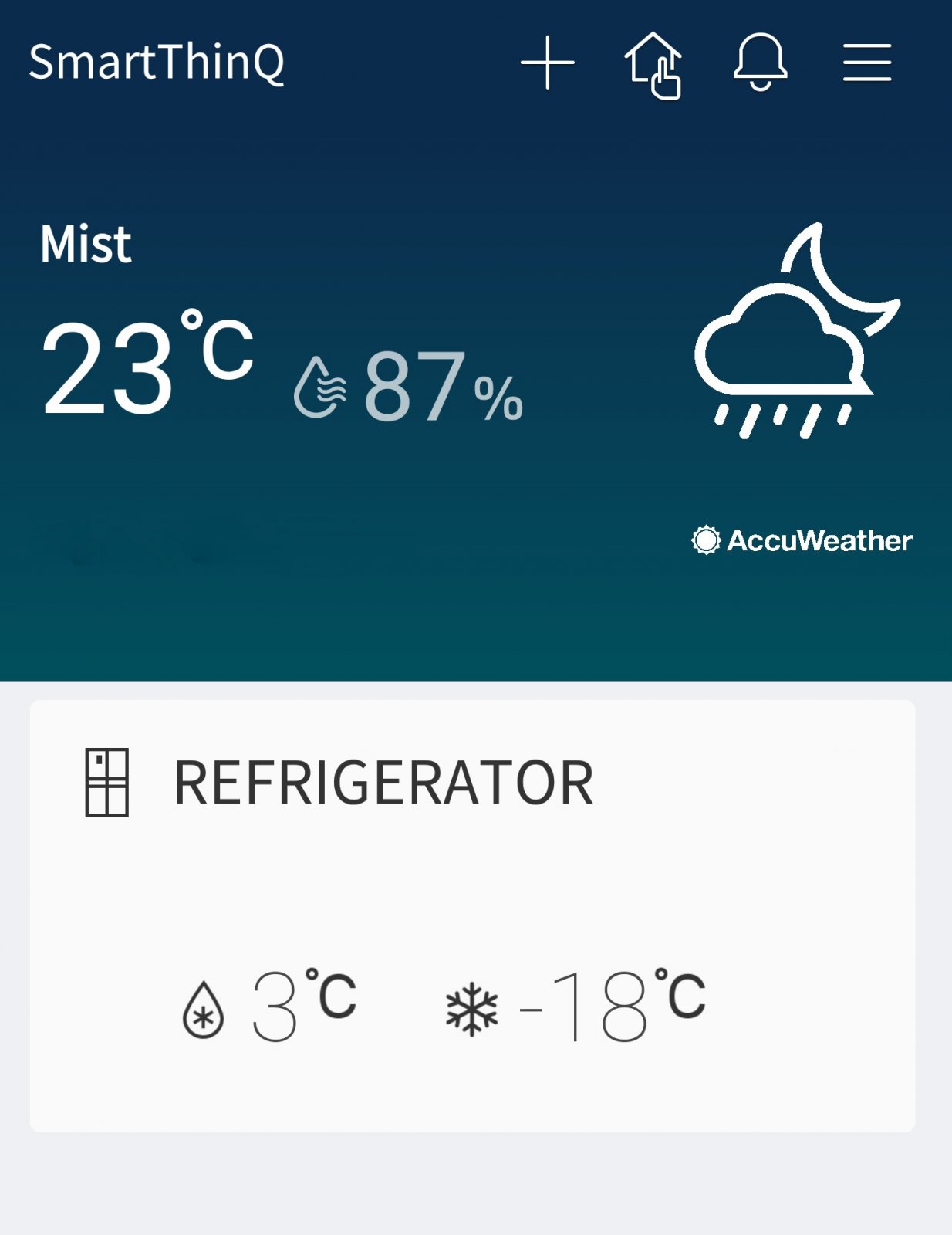

This fridge can be connected to WiFi. The app shows what the current freezer & fridge temperature settings are. It allows to change them and to switch on the express freeze feature. Hygiene fresh is an extractor fan that works every hour for a few minutes to remove bad smells in the fridge. HF has a power setting also makes it run more frequently. I left it on auto. There is a smart diagnosis feature that tells you the general status of the fridge. It also mentions how many times on average the door was opened. 41 times a day seems a bit high maybe we were a bit over enthusiastic when it arrived. It mentions the fridge should be loaded only to 70% for max efficiency so keep that upper limit in mind when going for a new fridge. 70% max loading seems like a good rule of thumb whether it be washing machines, mixies or a fridge. Our last fridge was packed to at least 90% (!)

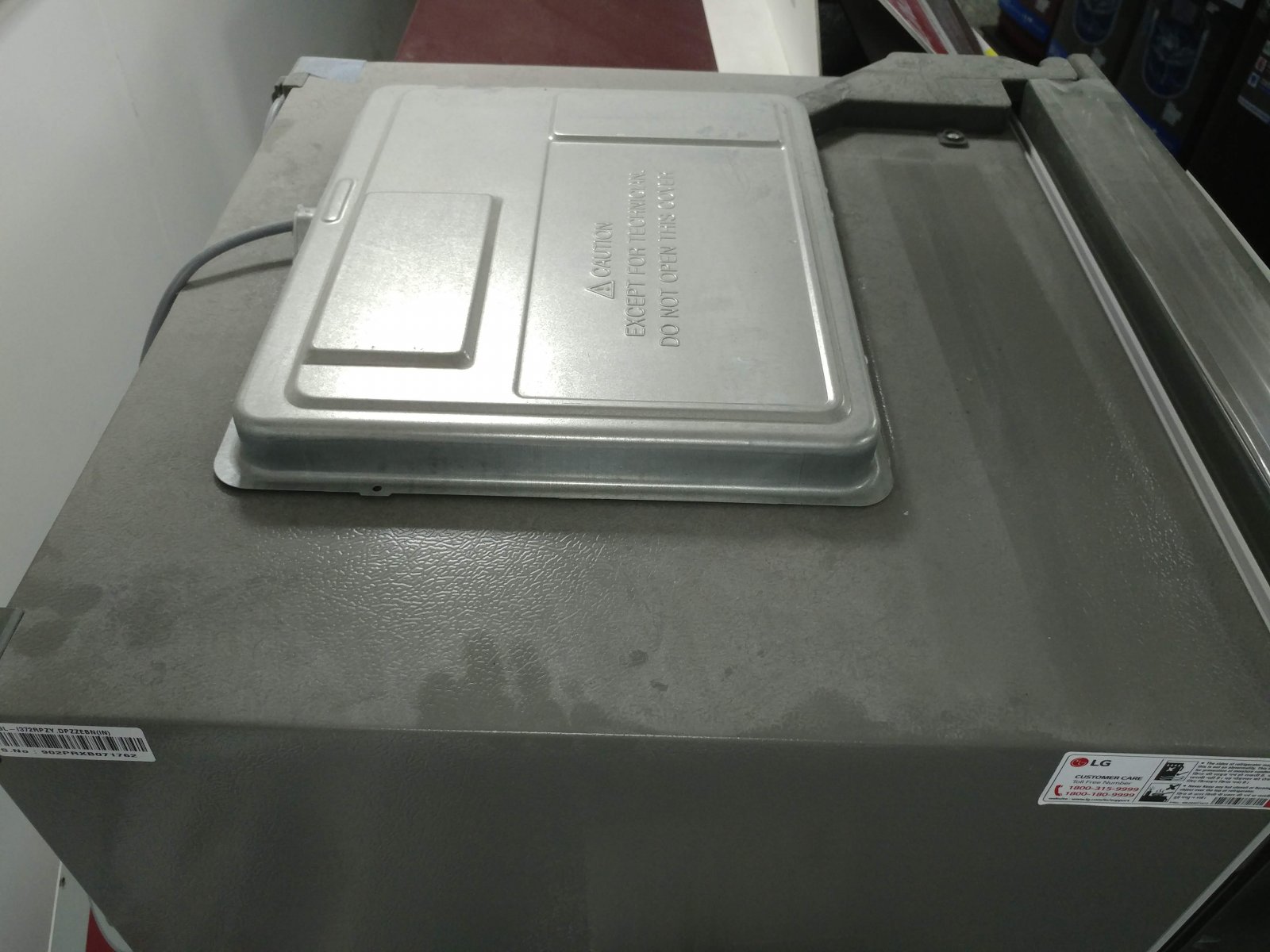

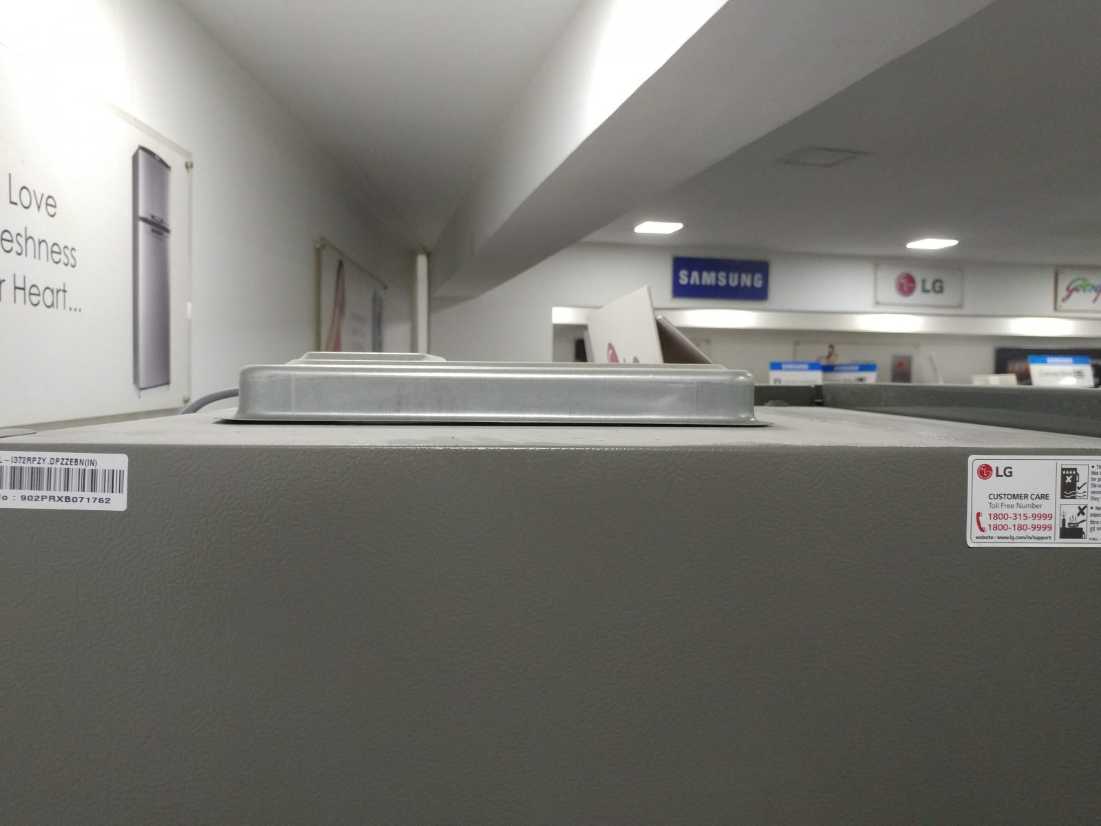

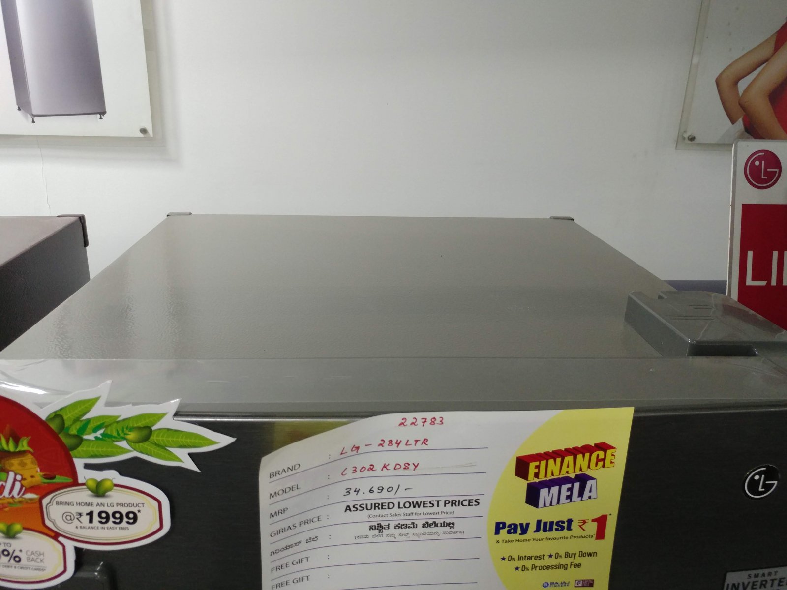

When browsing in the shops I noticed this thing on the top of LG fridges. Its only there for LG fridges with capacity of 300 -500 litres. Under 300 or over 500 the top is clear and flat. Apparently that is where the main motherboard is situated. Sticks out about an inch. So if anything goes wrong they replace the board from there. It's easy to access so a replacement is a half hour job.

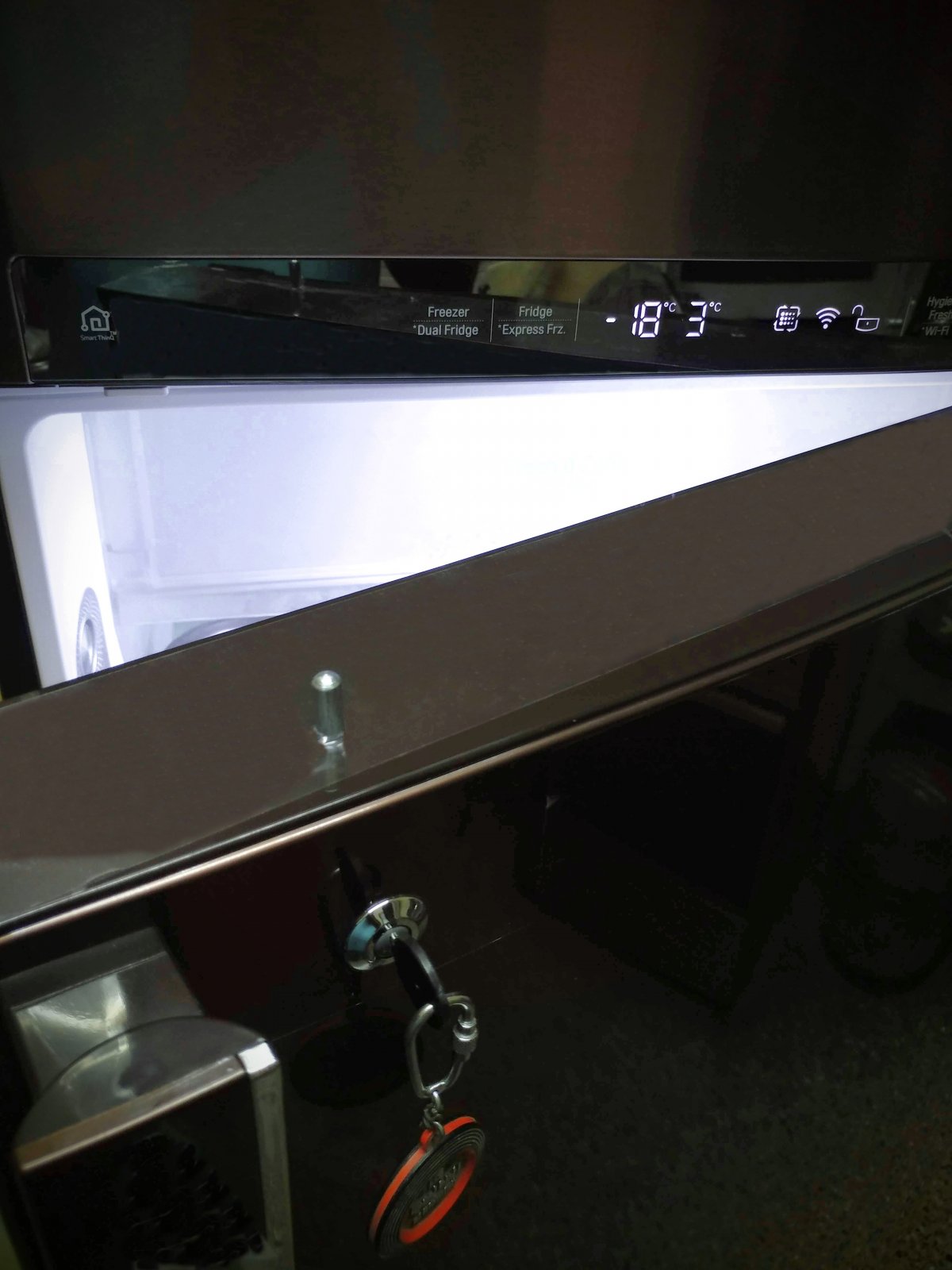

I settled for 1 cm higher in the front. The reason to raise the front slightly is it allows the condensed coolant to naturally flow back towards the compressor as well as making the doors shut by themselves if left open. If you fridge door does not shut by itself when open then the front needs to be raised a bit. Got it done, made sure it was level left to right then waited to see if the buzzing sound stopped. Nope, no difference at all but at least the doors shut by themselves now.

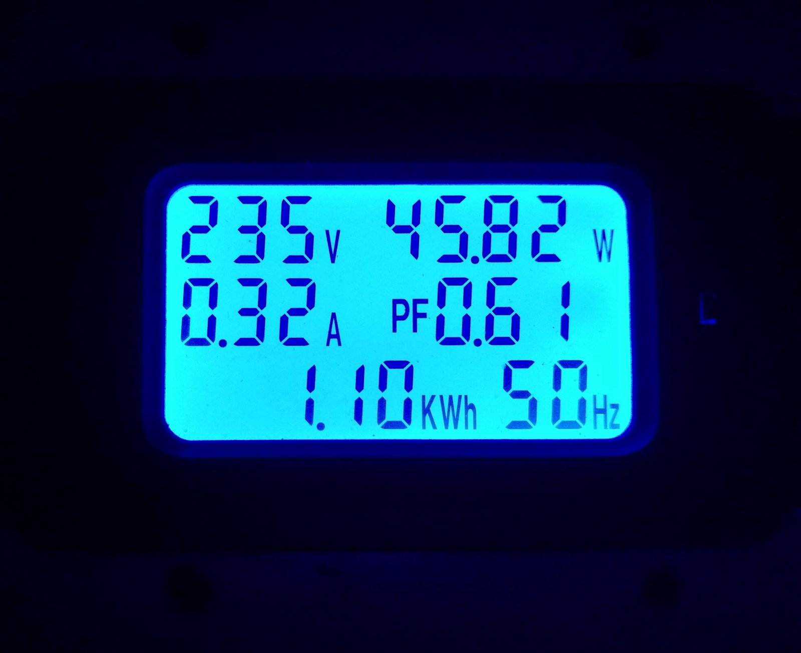

So how much power does this thing consume over 24h ?

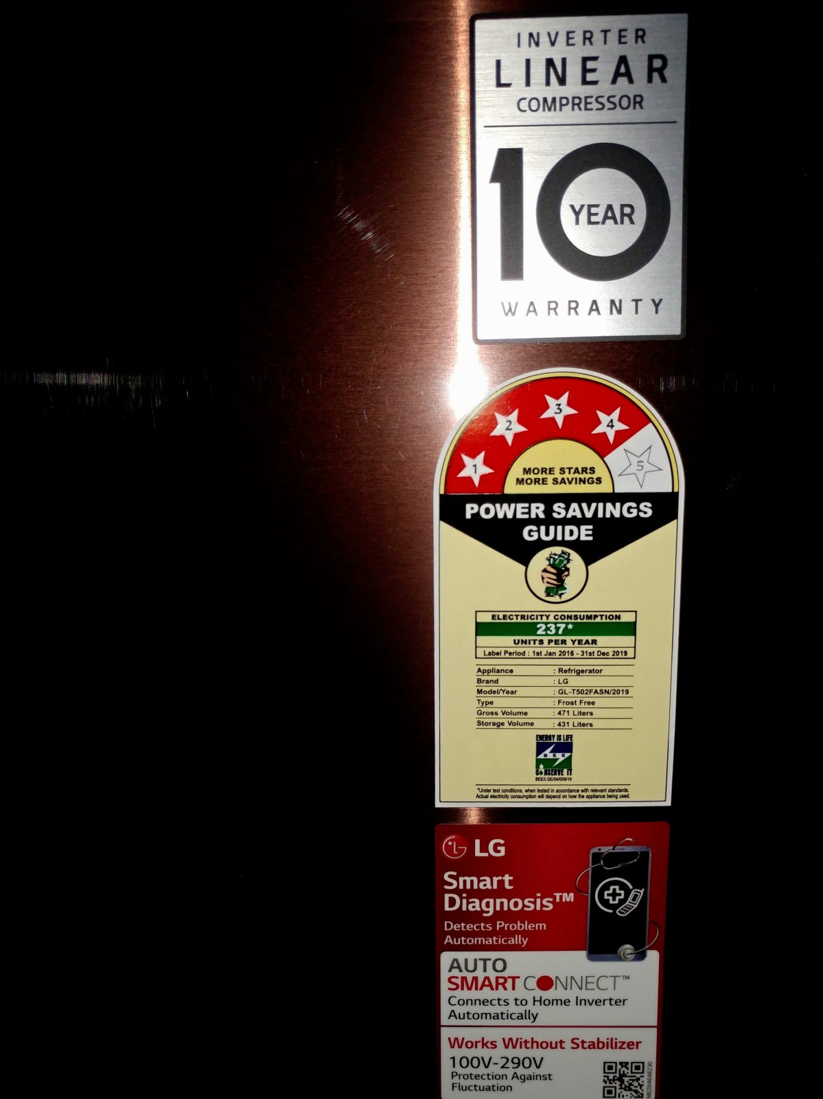

If we look at the BEE sticker it says 237 units/year which works out to around 0.65 units per day. Interesting thing is this sticker is dated 2019, the black variant i'd seen of a smaller 437 Lt unit said 2018. Good, at least its current.

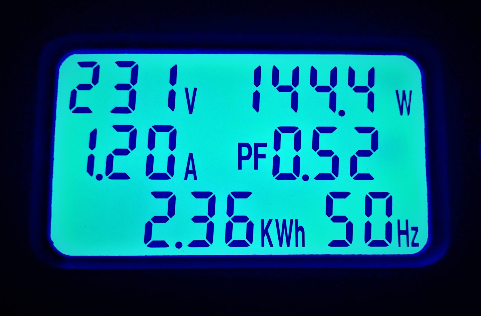

At a freezer temperature setting of -18°C and fridge temperature of 3°C, the power meter recorded around 1.1 kW after 24 h. After a few days i noticed this power draw was fairly constant. So at these settings it consumes half my previous fridge which is good.
As to why its higher than BEE's rating there could be several reasons
- does BEE open the door at all ? or is that a reading with doors shut for the entire day.
- ambient temperature could play a role. The fridge should be in a well ventilated area. My kitchen has windows and doors are kept open. I suppose it is ventilated if not well ventilated. But the ambient temperature right now is 28°C in the kitchen. In a cooler room the fridge might work less
- what temperature settings does BEE use. I suppose i could use less power if i raise freezer from -18 to -15 and fridge from 3 to 7°C. It would work less. I will do a power consumption test in the coming days at lowest & highest temperature settings to see the difference.
Right, now the fridge is fairly empty but it will fill up with time. So power consumption might rise a little more.

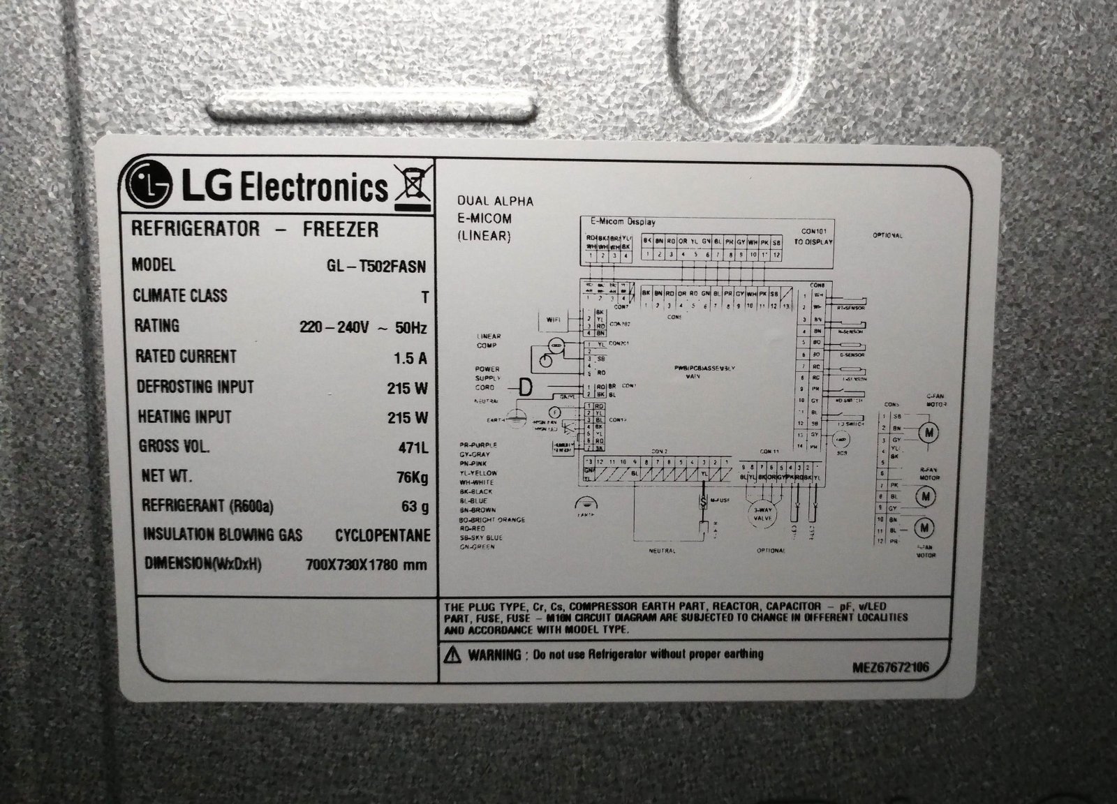

The instruction manual says the minimum size inverter to power this fridge is 600VA with a 120AH battery. I can believe this. At -18 & 3 for fridge, it consumes a max of around 65W. And when the compressor starts up it draws power very slowly, you can see the power meter taking almost a good couple of minutes to reach max power. There is no starting current for this compressor. The demo guy told me it defrosts itself every 9 -13h but i've yet to see power consumption cross 65W
View attachment 80293 View attachment 80294 View attachment 80295 View attachment 80296 View attachment 80297 View attachment 80299

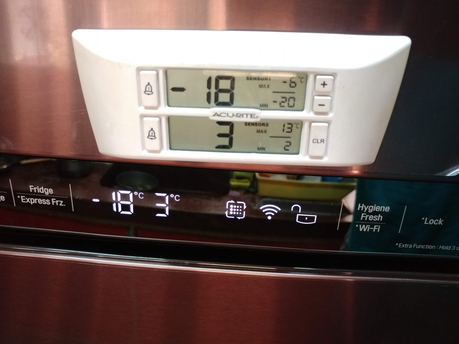

I think i 've figured it out, the power meter might not show min/max but the thermometer display unit does. If you see the photo i posted above you will notice a temperature range of -6 to -20 for the freezer.
I found this range a bit odd and it was hard to tell whether it was occurring due to normal use when we open the freezer door or not. But after observing for some time without the freezer door being opened it still dropped to -6.
So that must be when the defrosting is occurring ;)
I managed to catch it when it was at -6 and noticed the power consumption had climbed to 75W. Sides weren't any warmer than usual. I've not noticed any warming of the sides at all.
I need to catch it when the temperature drops from -18 as that is when the heater will be at max.
My impression of inverter compressor WAS that its constantly running and then increases when required instead of stop/ start like a conventional compressor. But i notice there are times it runs then it gradually slows down and eventually stops as the power draw is like 3W only to start up again later on and slowly climb to 65W.
So i did some testing at lowest and highest power over a few days and averaged it out.
At the lowest setting Freezer -15 & Fridge 6, power averaged 0.9 units per day. That is the lowest i can take it so i don't know where the 0.65 units per day from the BEE label comes from. There is no option to switch only freezer or fridge off. Both are on
The default setting Freezer -18 & Fridge 3, power averaged 1.1 units per day
At the highest setting Freezer -23 & Fridge 0, power averaged 1.3 units per day
So the spread is 0.9 up to 1.3 units per day
My thermometers confirm temperature as set is what it is really. Eventually they settle on the set temperature levels.
As for defrosting, i managed to catch it when temperature was rising and found it got up to 110W on the -23 setting and 80W on the default -18 setting. It does not stay at that max level for long, it rises up there then drops slowly.
Regardless of what the sticker says, the sides of the fridge do not heat up during defrosting, its a constant 30 degrees all over.
Finally, managed to catch it at the start of the defrost cycle
Back to the default -18 for freezer and 3 for fridge.
The pf at 0.99 shows its a resistive load and it gets up to 210W. Stays there for a half hour. Sides don't heat up.
