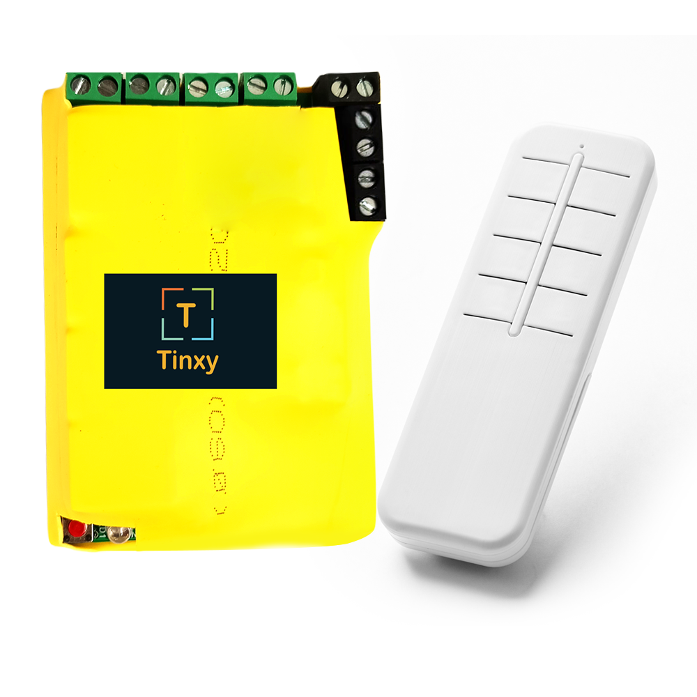

(a) Two Tinxy 6 channel relay to control 12 points - lights and fan

Would love to know how reliable these retrofit modules (Tinxy etc.) are in the long run? I have to figure out automation for my new house and I am considering retrofit vs touch switches. Any thoughts from a long term reliability perspective? @superczar
I am not using any touch switches so hard for me to say ..
I use regular switches wired in parallel with sonoff modules which for me at least have been very reliable for many years now ..

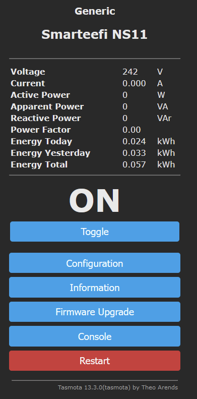

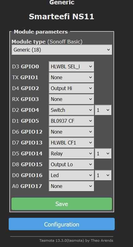

i have bought smarteefi 16a NS11 STD node retrofit series and was able to install tasmota and get the power monitoring working accurately easily.
all the circuit is having AC power so dont touch any wires incuding the switch s1/com wires when its on
use ftdi with 3.3v to power and flash by keeping it in flash mode by powering on with gpio 0 grounded..the com wire is useful and can use chrome webserial to get this up and running in no time. also u can use esptool.py to backup the stock smarteefi firmware, though i think its useless compared to what tasmota does
-http api support

->set timezone
->calibrate the device by using voltageset and currentset commands
template for the device:
-http api support
-mqtt support
-timer
-if pressure pump runs more than 15 seconds constantly, cut power, wait 1 minute and retry, for max 5 times.

->set timezone
