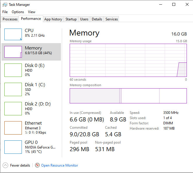

With XMP disabled it actually goes higher, upto 3500mhz
Should I keep it at 3500mhz or go down to 3200mhz

You sure it's going above 3200Mhz ?

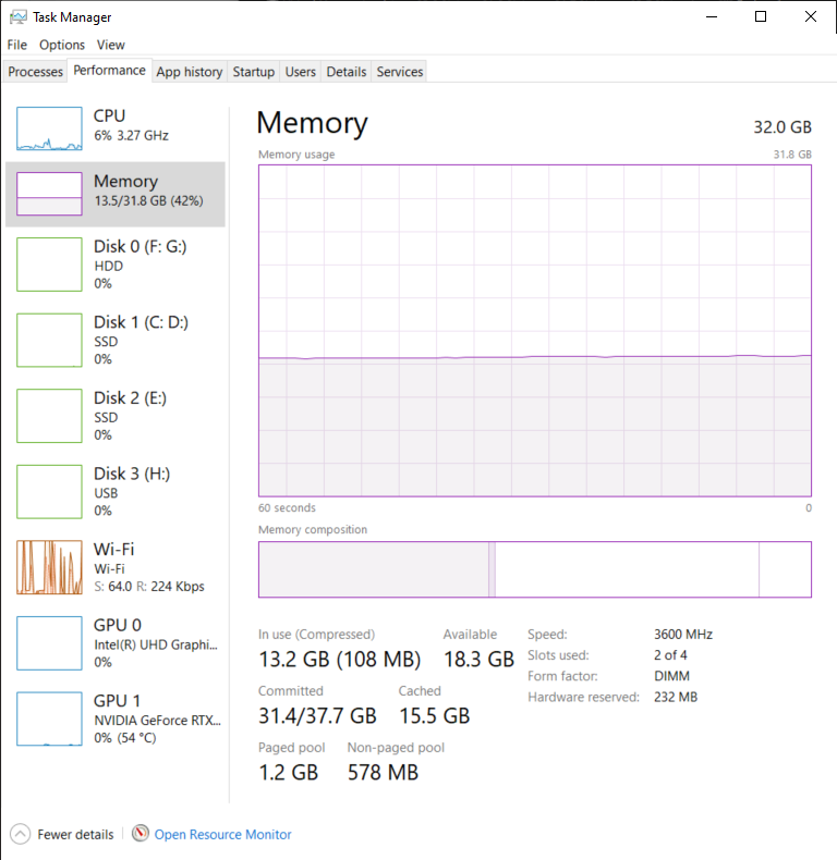

Check in Task Manager --> Performance --> Memory Tab and note the Speed with XMP On vs XMP Off.
Yeah i set the frequency manually in the bios otherwise it would be like 2666 or something
It wouldn't go this high with XMP on when i set the frequency manually

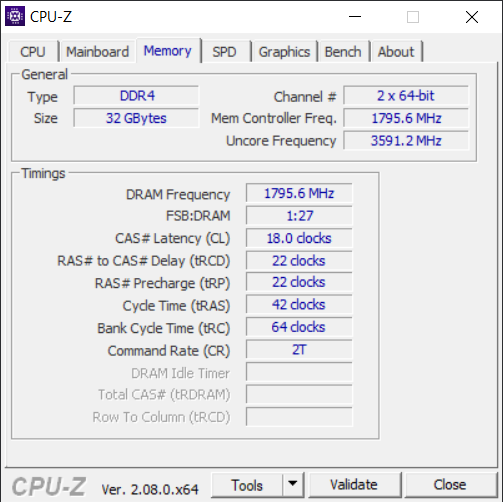

I have an i5 12400 with a B660 mobo (B660M DS3H AX). I can run RAM at 3600MHz XMP at 1:1 gear ratio. On H610, my CPU will be limited to 3200MHz as Intel doesn't allow XMP on H610.

That's why I am asking to check in Task Manager and share the screenshots of speeds with XMP On vs XMP Off .

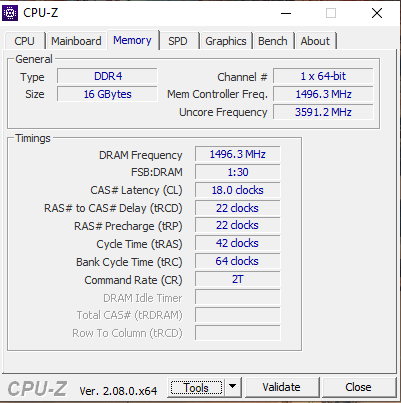

I'm running it at 3000Mhz because it won't boot over that.

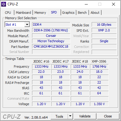

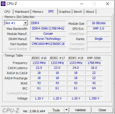

Btw this is the RAM that i have

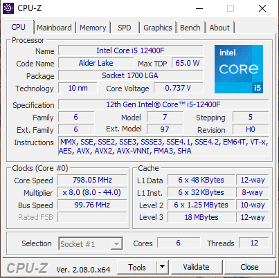

Can you check the CPU-z screenshot above and see if it tells if anything is faulty?
More SS for reference:

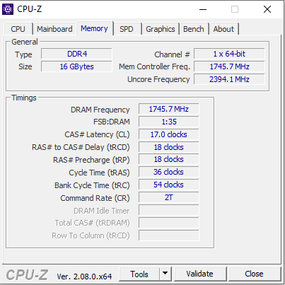

Turns out simply swapping from slot 3 to slot 1 allowed it to run at 3200mhz (Won't boot above that)
The reason i had it in slot 3 in the first place is because slot 1 is too close to the CPU cooler
What should be my next course of action? Do i buy another 3200mhz one because it only goes up to 3200mhz in my system?

I hope that you know there's an order to installing RAM sticks. Like my B660 mobo has 2 sticks on slot 2 & 4. For just 1 stick, it will be a specified slot (need to check mobo manual for this). Do read your manual for the correct slot for RAM in your mobo for single stick.
Hmm, I seriously can't get how is 3600Mhz working in Gear 1 mode with i5 12400f. As far as I can tell, it can go to a maximum of 3500Mhz which intel considers as OC and thus can void your warranty on non-K CPUs.
Maybe Intel changed something after backlash from the community cause at the launch of 12th Gen, people were furious at how speeds above 3200Mhz were causing crashes.
Or maybe Motherboard Manufacturers unlocked them through BIOS update. ( MSI did that but had to roll back after Intel intervened .)
Or Maybe , you got a good CPU Memory Controller.
Anyway it's awesome that it's working at 3600Mhz.

Check the screenshot of Memory Tab of CPU-Z.
Here If your DRAM Frequency and Memory Controller Frequency are same , That means it's 1:1 ( GEAR 1 )
If Memory Controller Frequency is Half of DRAM Frequency , It's Gear 2.
For Better Performance , Gear 1 is usually recommended.
In most cases, Going above 3200Mhz in Intel 12th Gen non-K CPUs, Controller shifts to Gear 2 working at half speed and thus limiting performance.
