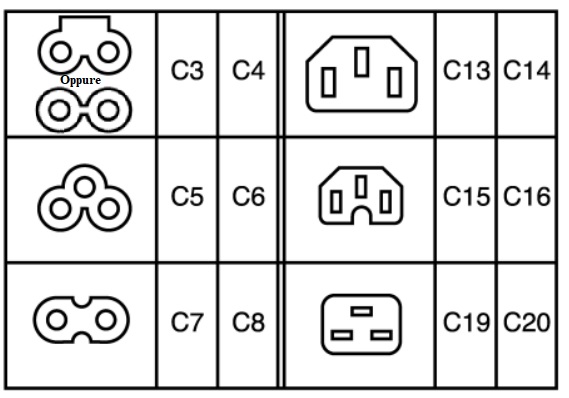

16Amp makes no sense.
In-fact this trend is being copied by other companies such as Lenovo, most of their "gaming" laptop comes with 16A plug.
Hey , thank for your link earlier, searching for "Mickey mouse" shows these cable in amzn.
That term did make me smile when i saw it, another is clover leaf which is a better term as it does not have a slang connotation. Doubt you'd find anything using it though.
