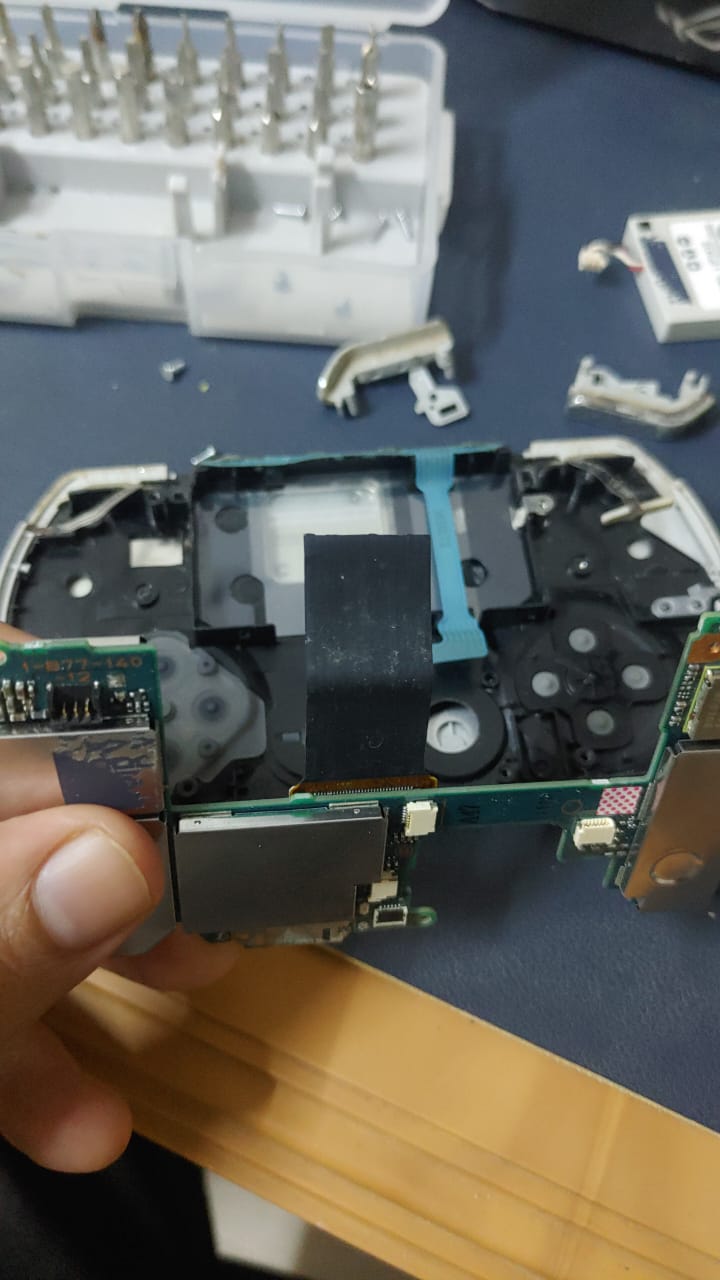

The owner said it doesn't boot up, but he doesn't have a charger to check if it's working or not.
He told me - he sold his previous 3 (!) PSP Gos, and all of them needed their display cable to be cleaned, after which they all worked. Claims it's more likely the case for this as well.

Got it for 2k, disassembled the device and found the culprit.

UPDATE - I connected my speakers to the headphone output and booted the console with the charger. I could hear the system sounds, means the motherboard is fine!!!
Now I have to source a display cable, battery (as this one isn't charging) and if possible a housing replacement, as the display is too scratched up.
Or if I can't fine any of these, I'll just buy a composite cable and call it a day lol. Hopefully it can display out and charge at the same time, lemme research that.

I managed to procure a display cable from aladdin shoppers (found the store from IndiaMart. Yes I was desperate). Seemed like a drop shipper (or not) because the parcel took 1 month to deliver. The cable appears to be fine as the speakers are working, but the backlight of display is not lighting up. Debating if I should buy a display, or just save up and pay 5-6k for a working PSP Go :/
