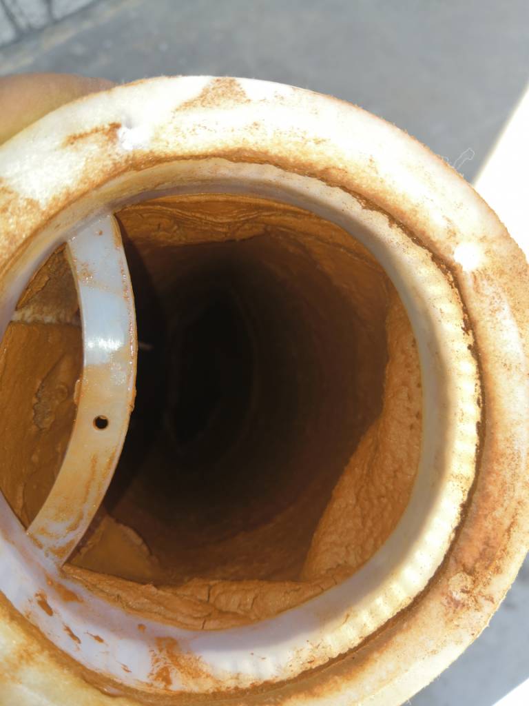

Also, just wanted to share a picture of my bag filter that does 99% of the work in my sediment blocking setup of my borewell water. We used to get this very fine silt in our water which you can see all caked up on the inside of the bag filter. The blown filter hardly gets to do any work and hence has not been changed for the last whole year and will last a couple more years.
This bag filter I use can be cleaned and reused. I use it in rotation with another bag filter that I had bought as a spare.
