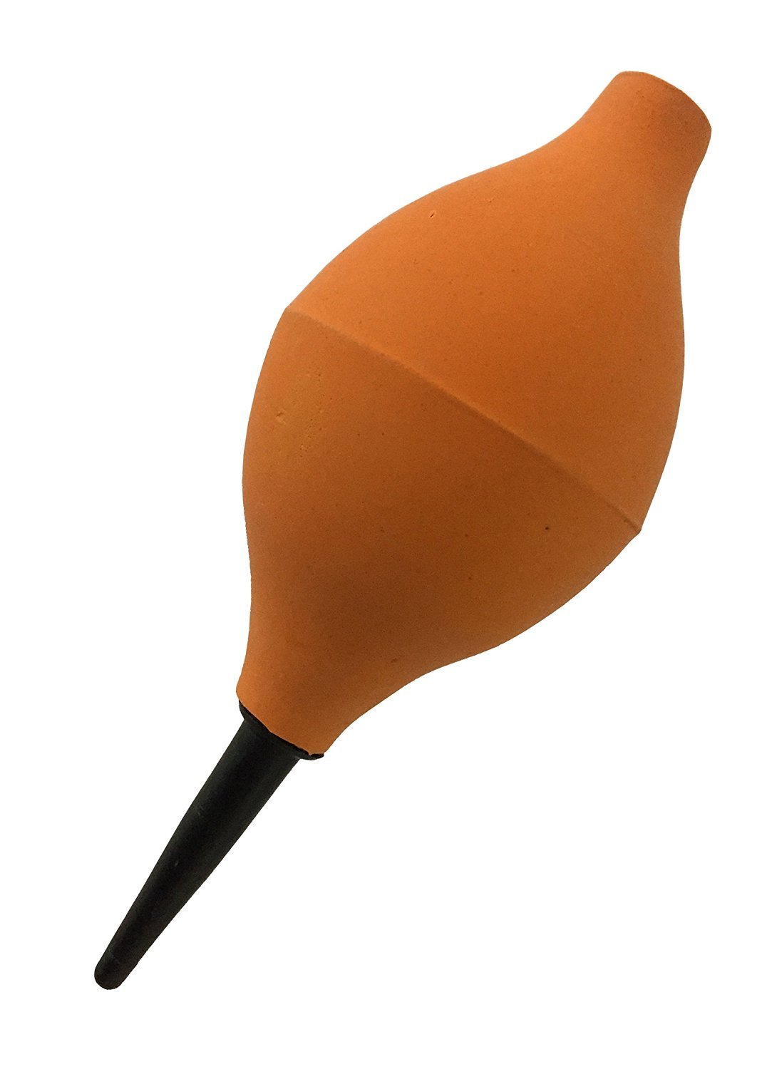

This works best for me. I've tried everything – large vaccum cleaners, handheld rechargeable ones and electric blower. A soft wide paint brush and a handheld squeeze type blower is best for clearing dust.
