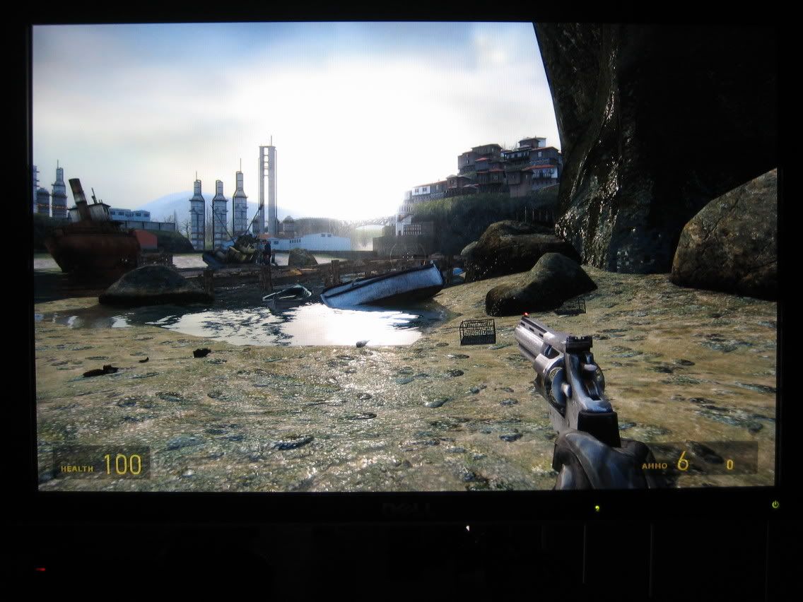

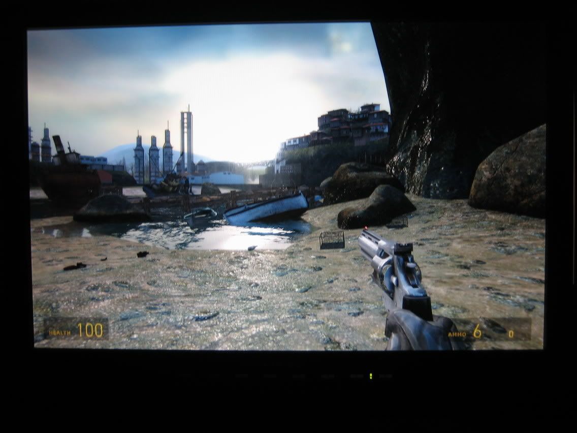

Okay below is a comparison bet. a Viewsonic VA2012wb (TN panel) and Dell 2007WFP(S-IPS panel). It's from Half-Life 2: Lost Coast.
Viewsonic VA2012wb
Dell 2007WFP
Source: widescreengamingforum.com
the viewsonic appears washed out compared to the Dell.The diff. will be more noticable in movies.I know TN panels have improved but they still have a long way to go.
