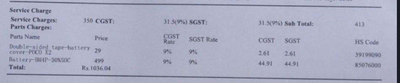

My Redmi Note 9 pro is 3.5 years old. Everything works fine, only the battery started showing abnormal behaviour. It's draining fast & phone is restarting constantly without a charger. So should I go to service centre for "original battery" that'll cost me around 1500 with 3months warranty or go to some local shop that cost 600 with 6 months warranty?
Also I read an article and tweet that Mi battery replacement should be around 499*. But I don't know why people won't talk about it.
Even tho battery costs 499, total comes to this.
