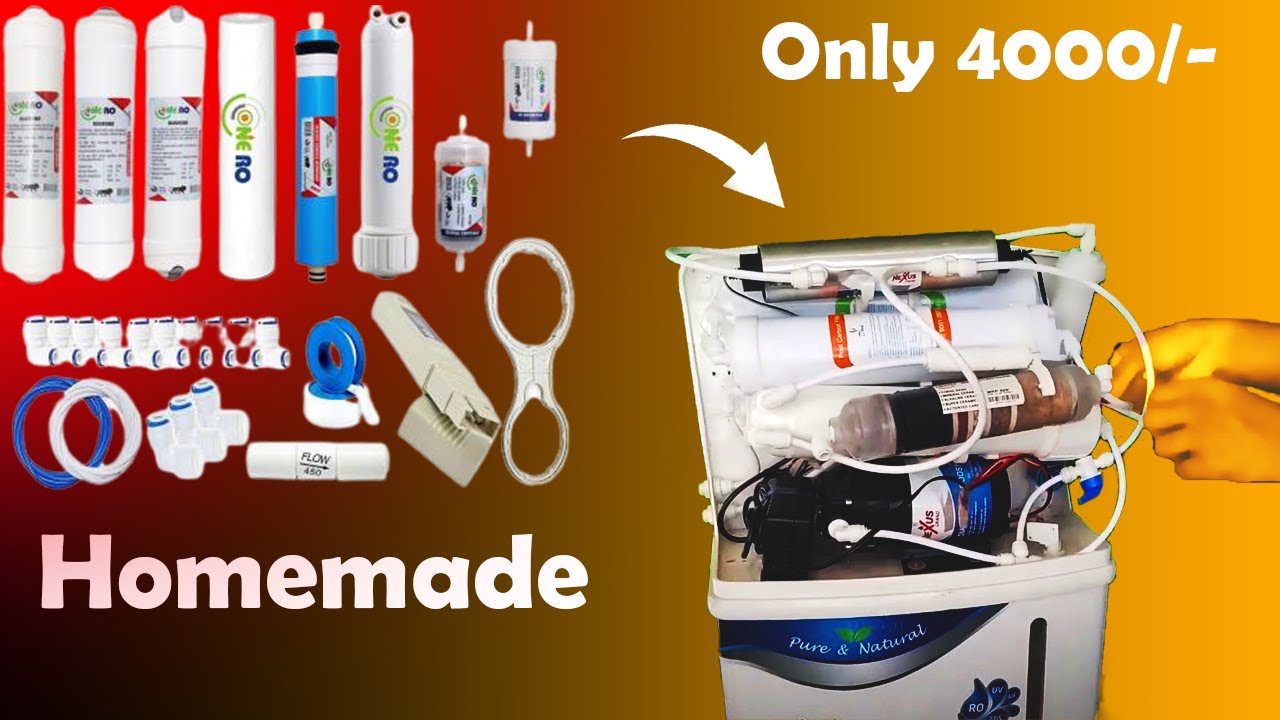

I made RO purifier my self a decade back and till date I have not spent more then 5k on maintenance even after all these years. This includes pump change thrice and membrane change once. With all other filters changed yearly to every quarter depending on the soil level of the water. So yes you are overpaying, all AMC on appliances are useless, unless you happen to get a lemon.

You can convert your existing one to RO you will need a genuine RO membrane and a pump, power supply and other small consumables.
Cheap no name Ro purifers use el cheapo membranes which cost around 500, reputed one costs around 1000, same goes for the pump reputed one costs 1.5k to 2k retail.

I have spare sediment filter, carbon filter and uf filter. I have a spare uv bulb of Philips too. No case to put all of these inside though. Problem is i don’t know what a genuine ro membrane or pump looks like.
I though it will be cheaper to just buy a new no name ro with uv+uf and storage and then change the individual components with my spares when needed.
Can you post details about your build or youtube videos that have the details. I am interested to try this
Are these parts are of universal sizes, then only, they will be a fit, nevertheless, its better approach to try
Yup, parts are universal sizes. If you want to know how ro purifier is made see this video.
Cost now is way above 4k for the parts.
Edit: that uf filter he’s using is a fake. I saw YT video where one such uf filter was cut up and there was just sponge and 1/3 quantity of actual uf membrane.
Real ones are longer and look like ro membrane.

I thought you already have a case, by case I mean the tank, and lid assembly to hide all the filters.
Those spare filters assuming its the universal type can be use on any ro/uv/uf purifier.
