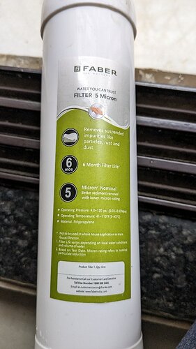

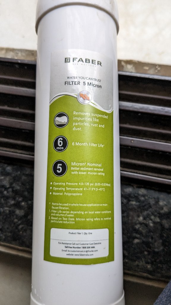

Is there anywhere we can get Faber ro filter replacements from? The company seems to be using non standard filter and they are charging a lot during replacement. Their amc cost is 5800 rupees a year and i see their ro filters unit sell for around that much. It’s nuts. It’s like buying a new ro unit every year and scrapping the old one.
The sediment filter width is 7cm (2.75inch) and height is 25.8cm (10 2/16 inch). This is the only non standard part i think. Even the filter inlet is double than 1/4 (3/8th?) but outlet is 1/4. And it’s a 50 micron filter.
The above two seem like cheap filters and cost 599 each. The sediment filter costs 299. The ro filter around 2300 i think. And these filters only last 6 months and the ro filter lasts 1 year instead of 2 years like the generic ones.
Searched Amazon and just a few sellers selling the 7cm filter but height of filter is smaller.
I have the 2.5 inch filter and it’s like half of the filter housing and it doesn’t sit properly since its about 3-4mm smaller in height.
Should i just replace the non standard filter housing with one of the generic ones? It will be easier to maintain and cheaper. An entire RO replacement kit comes for around 2-3k for good quality ones on Amazon now.

I found that site through Google and the quality looks really cheap. I’m sure those filters are just generic ones being sold for double price and they won’t fit. The faber sediment filter is 7cm thick and these guys are selling 4cm filter. Doubt that they tested it before claiming that the filter works. I have a bunch of the 4cm filters and enough spare parts to build a new water purifier and i can vouch those 4cm filters don’t fit. I actually tried to force fit one of those but the difference in height made the filter wobble inside the housing. The 10 inch filters are about half a cm smaller in height.
