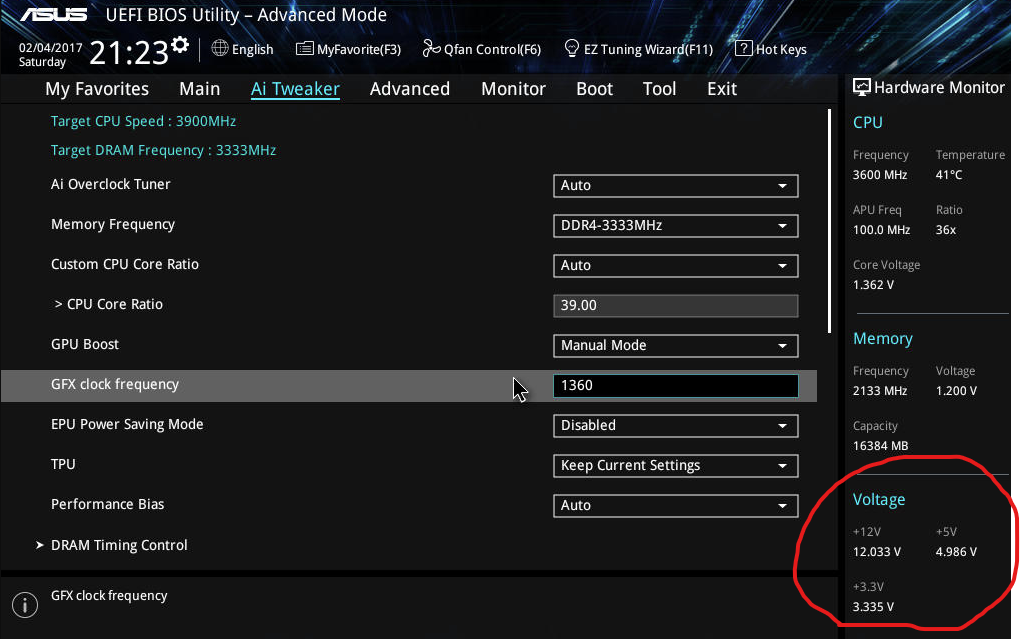

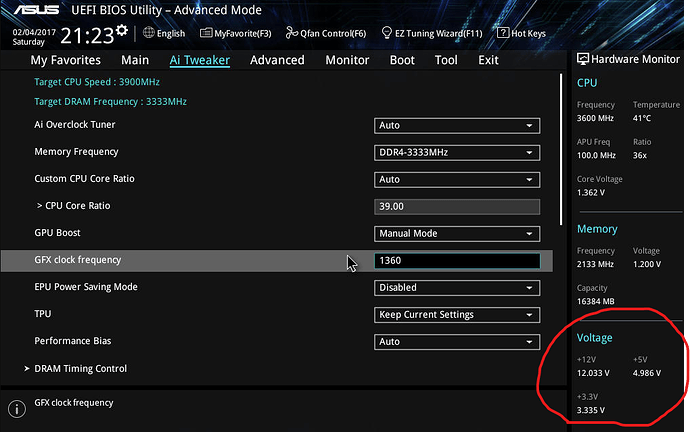

check your ATX and CPu power pin on motherboard are tightly connected .basically whenever your pc pulls more power /autoboosts the power supply is not able to provide it .And also check in bios whether voltages remain stable in the prescribed vrails observe for a while .Some times you connect multiple devices on a certain vrail and it is not able to handle it.if you have non asus board please find similar in your UEFi you will have it
