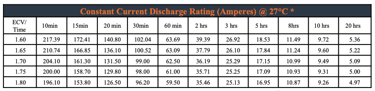

In an ideal setup, if your computer pulls 500W then you’ll need a battery 20 times the size of that, to run it 20 hours to get a discharge rate of C20 (C = capacity, C20 = capacity/20).
C20 is what a lead acid battery is rated at for the capacity, so a 100Ah will provide 100Ah if it is discharged for 20 hours so 100/20 = 5A or 12V x 5A = 60W. Apart from capacity, this low discharge rate will give about 7 to 10 years of life, depending on the datasheet.
So you’ll need 500W * 20h = 10000Wh in your battery in the ideal setup, that’s 10000/12V = 830Ah, or 8x 100Ah batteries at a cost of about maybe Rs 50k. A bit ridiculous but then you wouldn’t need to worry about your UPS/inverter for ten years so it works out to 5k every year.
Or, you could just a buy a new battery every year, which works out to be more or less the same (8k for the first battery and a credit of 3k during exchange for all the others).

The Watts x 20h calculation is for getting the longest life (in years) out of your battery as lead acid batteries are rated for C20 operation.
So you’ll get 100Ah out of a 100Ah battery and it will last as long as the warranty claims or longer, if your power draw is no more than C20 or 100Ah/20h = 5 amps which is 60W for a 12V battery.
As an example, Amaron says if you draw 25amps (300w) then you’ll only get 75Ah from a 100Ah Quanta battery, or a run time of 3 hours.
By getting 8x 100Ah batteries, a 500W load will only draw 500/8 = 60W or 5A from each battery, so not putting any kind of strain on them, allowing them to last a very long time, around a decade.
You could pragmatically go up to C10 or even C5 and still see a very long battery life.
Or just get one battery and replace it every year or two.
