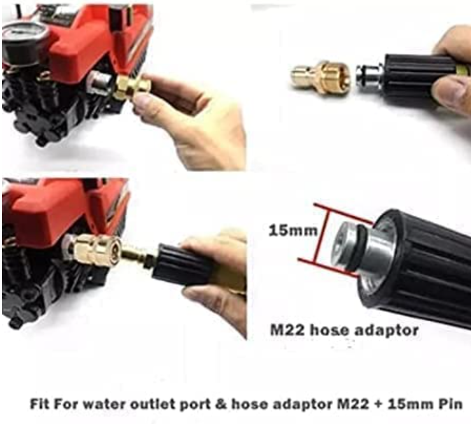

I have seen threads of this inlet outlet pipe gets stripped when people screw and unscrew their hoe hoses on regular basis, I suggest just screw it once and leave it, and also don’t over tighten it.
Otherwise this Quick connect/disconnect accessory exists, which is made of brass, much higher quality. But if we are trying to spend as little as possible on a machine which is not meant to be reliable, then it’s better to just avoid. Set it up once and leave it.

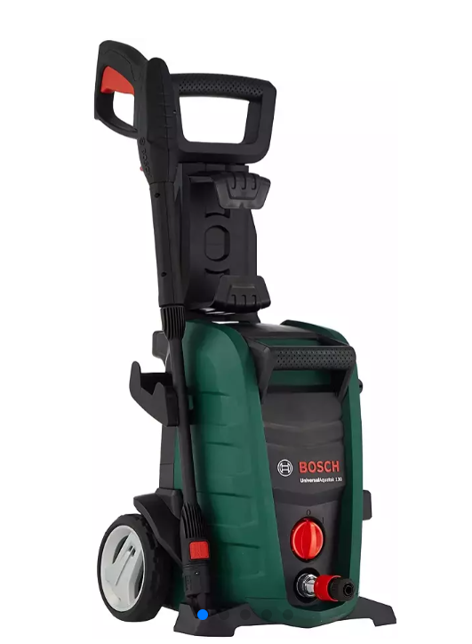

One in my family has this bosch pressure washer, I have used it too.
The only problem with this was the gun, it leaked every year, making the pressure washer useless, we had to buy the gun again and again, I think it costs around 2k. Rest of the machine is solid, we are suppose to service it, but we never did in the 7-8 years. So when we spend extra money on these, we get a reliable main product, the accessories will break, but the actual motor is solid.
But the worst part for me about this is the noise it creates, it’s ear piercing. The cheap 3-4k pressure washer are made on inferior technology but they produce far lower non-harsh sound.

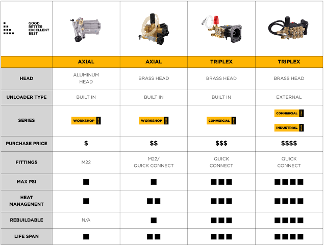

Any pump that has a wobble plate axial pump design will have lower life and very loud.
Triplex brass pump will have a much longer life and is quieter.
Any particular Triplex model that you can recommend that can be purchased in India online?
BT 1200 HPW while I haven’t used it. I have seen this and specs like pressure rating is over inflated by 30% by the indian importer/rebadging stuff. But you get spares. You can see in their own products how the addition of triplex pump increases the cost vs a regular axial pump.
I personally use bosch GHP 5-13C which has a made in Italy brass triplex pump, it’s a workhorse. Notice how overinflated the indian importers spec the chinese stuff compared to bosch for the given watts of the motor.
