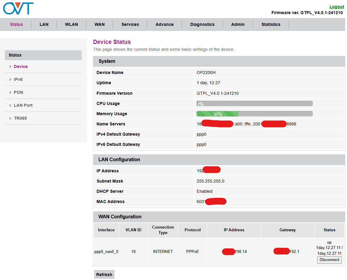

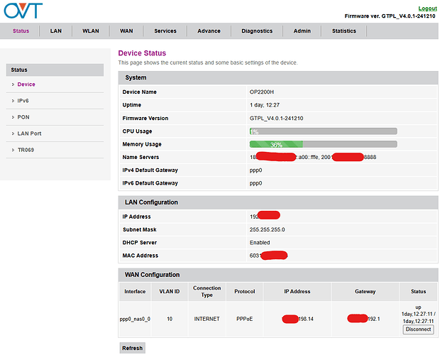

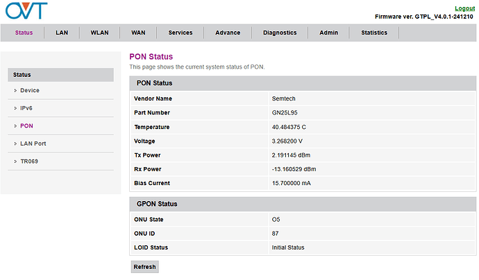

I am setting up a load balancer ER605 with two ISPs - Jio and GTPL (I am based in Ahmedabad).
Thanks to the help on this forum, I was able to bypass my Jio ONT. Now seeking help / guidance on replacing the GTPL ONT.
Things I have already tried and didn’t work
  1. Trying the ONT in bridge mode. The configuration happens, but it doesn’t work as expected. According to the technician it won’t work in bridge mode configuration.
  2. The technician arranged a configured ZTE GPON that GTPL used in the past, but that is also not working. As soon as I connect my ER605 load balancer to the ZTE GPON, I won’t be able to login at all. And GTPL have disabled the LAN port on the GPON so I cannot login to GPON also to configure.
Please consider below information…
  1. GTPL uses PPPoE connection and I have the user id and password.
  2. Refer to images below for the ONT provided…
