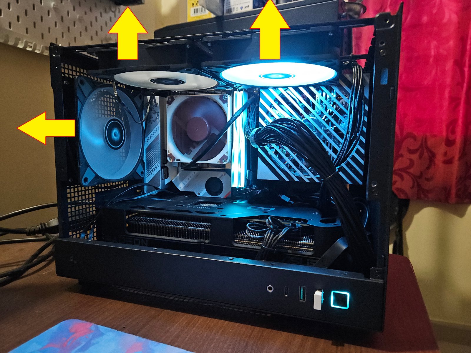

Folks, I have some question on fan placement for my CH160.
The fans (arctic p12) are all exhaust creating a negative pressure inside, while the temps are fine. Its causing a lot of dust accumulation.
Am unable to mount the fan at the front as its suited for a slim profile fan only nor I have room for any DIY to tie down the fan. I have to install them as shown below.
My questions are.
1. Can I use top fans(both) as intake or its a bad idea? or use just one (top left) as intake?
2. What other options I can try?
P.S ignore the fan lighting, I had not daisy chained the RGB cables.
case has very large unfiltered holes. dust will always find its way no matter the fan orientation man.
OT but i think you can change your CPU cooler to tower style one for better CPU temps. having 3 fans pulling away the air away from that cooler isn't leaving much air for CPU cooler fan to pull, unless you have low TDP CPU like 7600.
^ am running 7600x, on full load its around 65-68. I was contemplating on deepcool assassin 4, but barely leaves room for front panel cables and fans at the rear. Won't rule it out completely.
I previously used Fractal meshify c which was impeccable at keeping dust out. Maybe I should lower my expectations with CH160.
Any experience with using dust filter like this one or it would choke the intake?
yeah 7600x doesn't need a big cooler, just for gaming and casual tasks. speaking of dust filters, they look fine and shouldn't choke.
best thing would be to regularly dust your components imo.

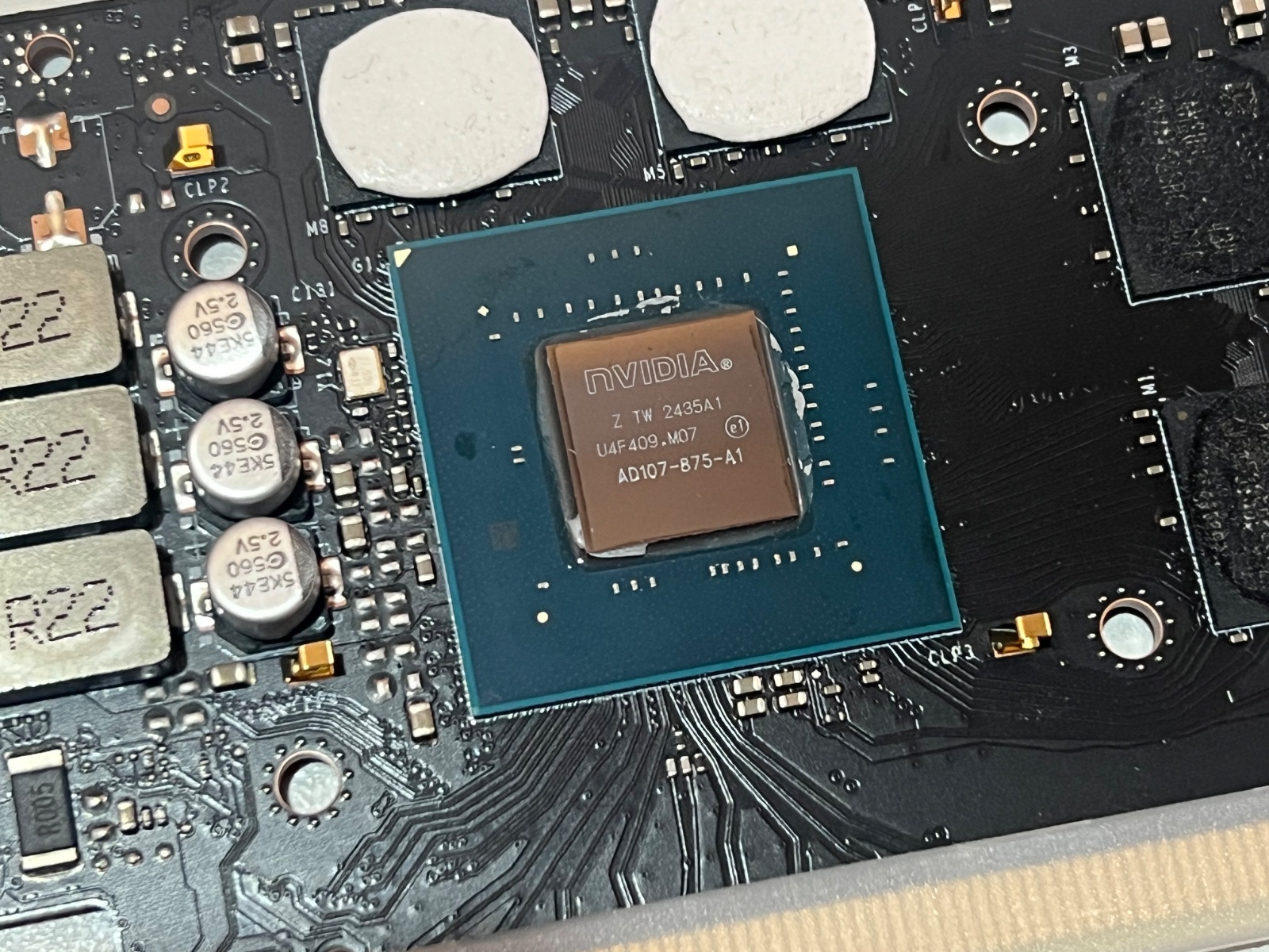

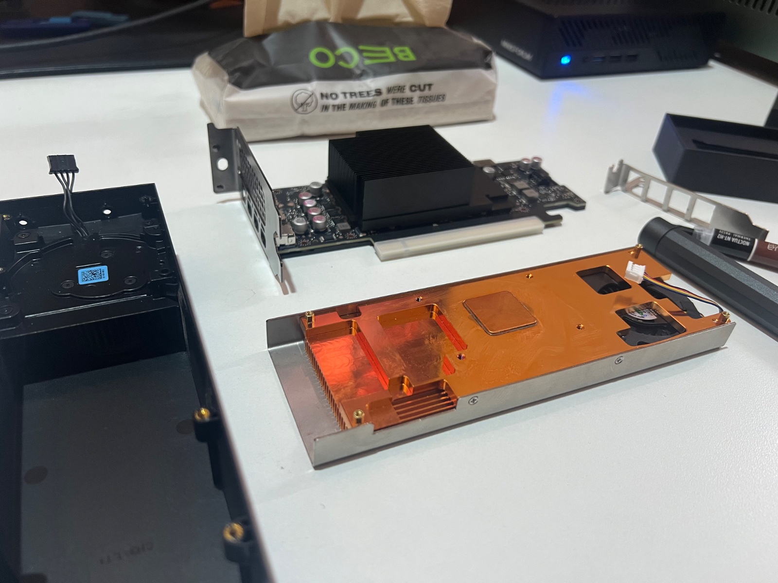

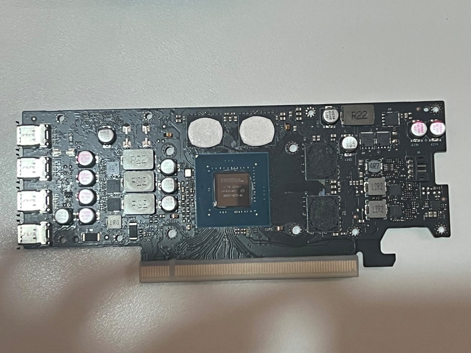

In pictures : Nerdware Cooler Mod for RTX 2000 ADA.
I initially wanted a RTX 4000 SFF ADA, but ultimately decided against it. The single slot cooler struggles at stock, with sustained workloads pushing temperatures to high 80s. I plan to undervolt over the weekend. Will publish the results in a separate thread with relevant benchmarks.

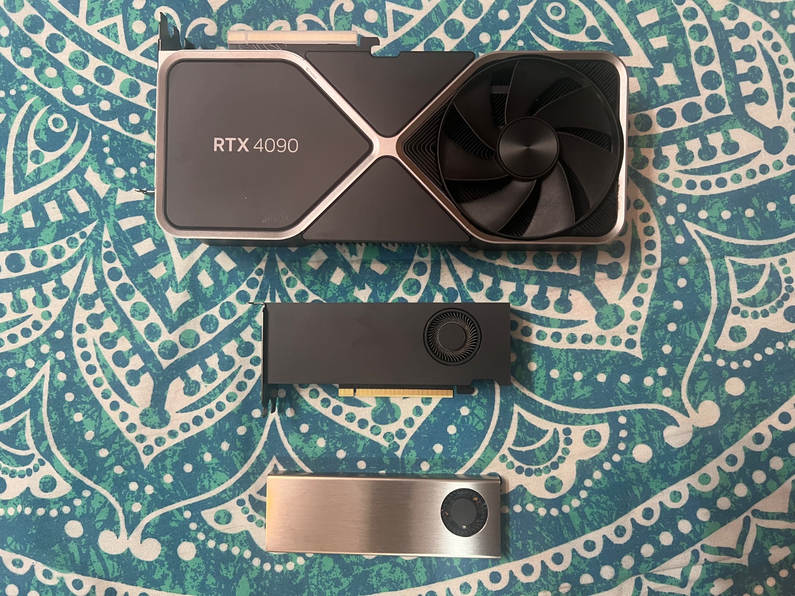

Last pic is for size comparison against a 4090. This thing is tiny AF

I'm not sure about the Ada generation, but the RTX A2000 at stock exhibits GPU clock spikes and also runs hot, even at 70W. You should see quite an improvement by adjusting the voltage-frequency curve. Mandatory if you're using this in a tiny chassis. By some reports, the all-copper N3rdware cooler is better than stock, despite occupying a whole slot less. Have you compared the two? I look forward to the benchmarks and testing data!
The max I saw in stock cooler (albeit different chassis) was 73C. The problem with nerdware cooler is airflow volume (or lack thereof). I wish the fan was bigger, or faster. Looking forward to the undervolt. Maybe a better thermal paste too.
