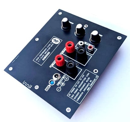

So I reached out to the guys from inkocean.in to get their help in finding a replacement for this, if they had one. I specifically asked them for an amp with active RCA out, and this is what they recommended - https://inkocean.in/products/active...x50w-100w-2-1-channel-tpa3116d2-digital-sound
But, from what I can see, these don't seem to have RCA out. The 2 jacks just beside the knobs are RCA, but the other 4 are not RCA from what I can tell. I asked them that these don't seem to be RCA out and they insisted, even highlighted the outputs when sending the picture back lol.
So can anyone tell me if I'm being nuts and that these are in fact RCA? Or are these guys trying to take me for a ride and just get me to buy the amp.

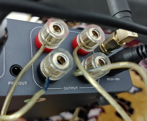

Deal of the day: AIYIMA A07 TPA3255 Power Amplifier 300Wx2 HiFi Class D Stereo Digital Audio Amp 2.0 Channel Amplifier for Passive Speaker Home Audio (Without Power Adapter) https://amzn.eu/d/dGt5h7W
5130/- after card discount
Never seen it go this low ever... No bass treble control, pure natiral audio..
What kind of output jacks does this one have? Looks similar to the one I posted above.
Two pairs of banana output sockets
To add here - the way that this system is set up is wall outlet>amp>speakers via RCA (fixed on the speaker side). The speakers don't have any power input, and hence need an active signal from the amp.
This is a plate amp mate, the ones that you find at the back of most of active speakers..
The 2 rca are RCA. IN, in case you are sending signals from a media player or another amp, or your preamp or DAC etc...
Other inputs are I guess the aux 3.5mm and bluetooth in this.
The 4 banana ports are the only output in it.. Please note you can use banana plugs or you can use bare wires in them.. I have deduced that bare wires work far well, that's how I use them
Other way out if you wish to use it is you can make a custom connector by attaching bare wires to bana sockets and then soldering the other ends to 2 pairs of rca sockets.. Would hardly cost 100 rs at most.
