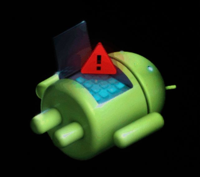

my phone currently looks like this when i booted in cwm after following this guide for rooting ics Hack notes on Pantech Burst/Presto/P9070 with ICS update 10/3/2012 | TAU ? It's All About The Negative @attn1
kuduku crackuc
what to do?

I only did it once , i got a message superuser installation aborted & i rebooted,phone was rooted & working , i booted into cwm to make a backup, there wa no option to backup/restore in the cwm menu , when i choose reboot i get the above screen
kuduku crackuc
what to do?
You are on stock Android Recovery (3e) . Power button does nothing here except remove the text.
Home button is for selection, volume keys for up/down.
kuduku crackuc
what to do?
