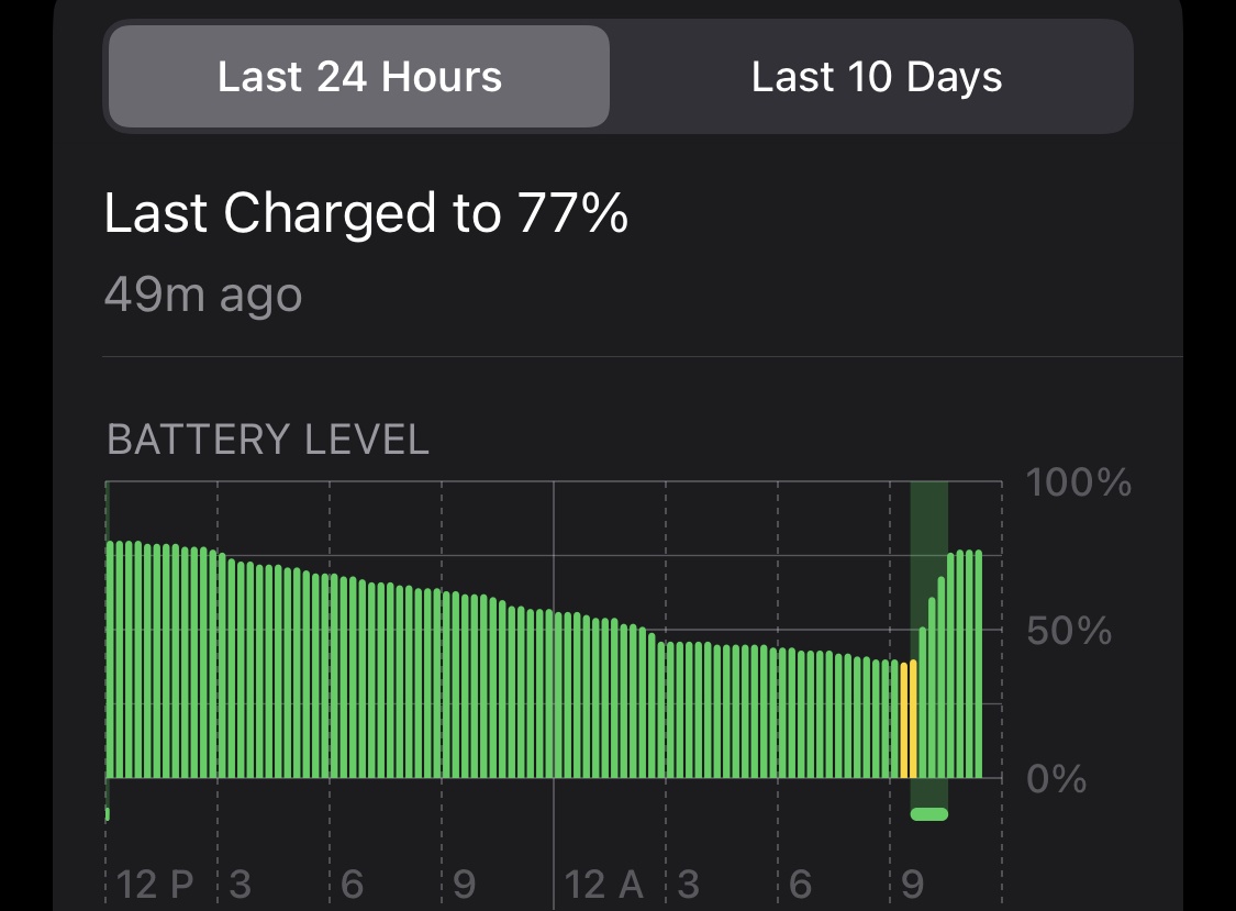

I was using it until somewhere close to 3 am, so may be 5-6% for a 12 mini over 6-7 hours. I don't charge beyond 80% but if you do charge to 100%, it will drop even less because of how iOS calibrates the battery, so in that sense checking percentage drop is pointless, especially when you consider different battery capacities.

5-6% over 6-7h means a standby drain of a little over 1%/hour. That's not bad but ideally, it should be half that. You want to be around 0.5%/h
