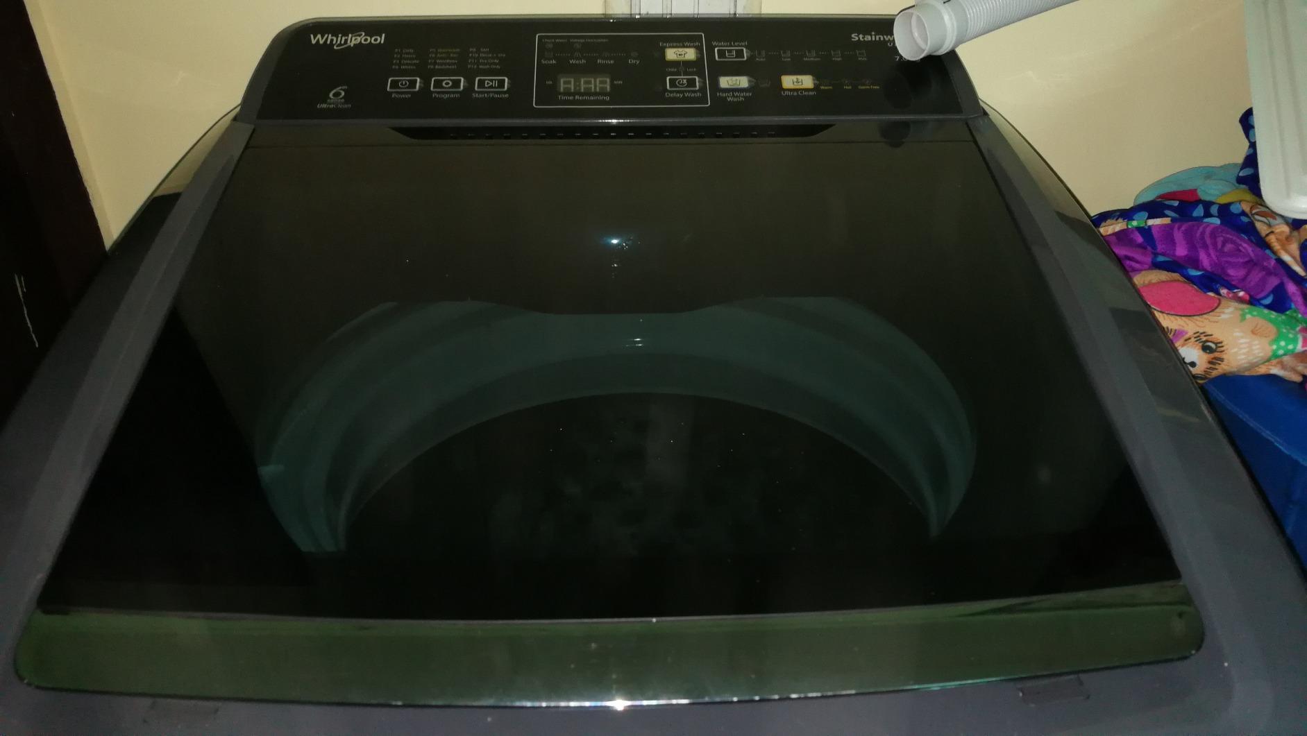

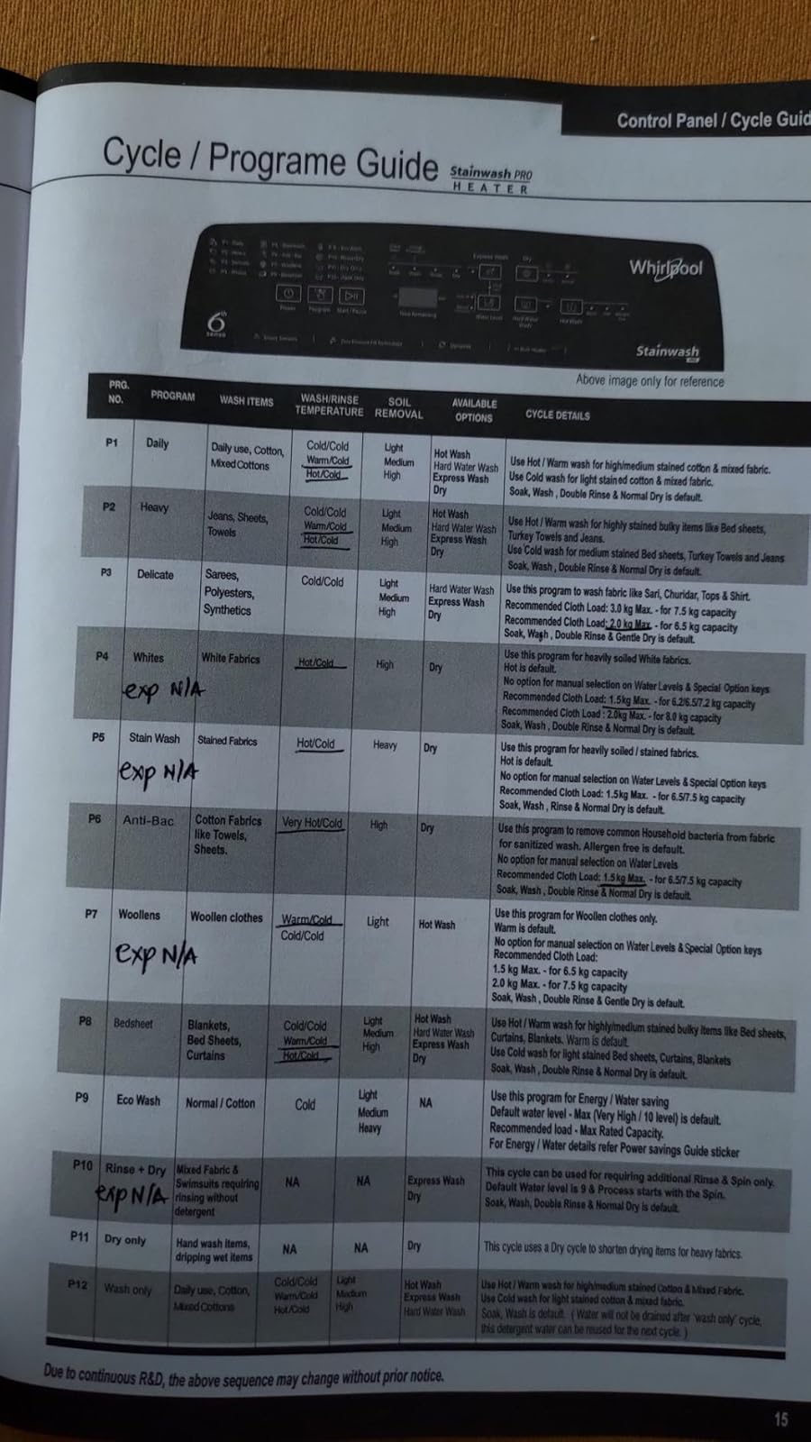

What I'm noticing with these whirlpools is they
- lack an imbalance sensor. So they will start spinning and shake violently like this review if clothes aren't evenly distributed. So you have to redistribute the clothes yourself. They won't try and adjust the load on their own. An auto balance sensor is an important feature to have. OR the transit bolts have not been removed. IN the review above she says you must only wash a full load otherwise the machine goes out of balance.
- Lack a manual mode. If you want to add more rinses in the cycle its not possible. You have to run a separate rinse&dry program after. Which is ok but would have been better to have the option to add an extra rinse if desired.
There is no manual washing option. If you straight away want to jump to washing in any of the wash programs (from P1 to P12) then you cannot do that. It is something should be given but you will need to stick with it and let it do its thing. But this feature should have saved a lot of time. So in a normal washing program machine will do the soaking then wait>washing>waiting>Rinse>waiting>spin/dry. So you cannot straight away jump at things. If you accidentally pressed the stop button then program will start from soaking again which is painful to watch because you know it was on the washing phase but you cannot push it forward to your liking.
P11 is wash only and P12 is dry only., that's about it.
- No drum clean program but that can be improvised using the heavy program and hot water.

If you look at manuals/ cycle chart of most Front loader. They claim you can put the Max load at cotton cycle, all the front loaders increases the wash time by 2x to 3x vs say a daily/mix load cycle which is usually capped at 2.5kg to 4kg which is done in around 1hr.
In LG most of the 7kg have the smaller depth then the 8 and 9kg models. Only one 7kg model had a drum same as the 8, 9kg.
The lg 10.5kg model has next bigger drum size.
But even in this model for the mixed/daily load cycle, it can only take 0.5kg higher load then a 7kg, 8kg, 9kg models which have the same size drums.
But the hard to find whirlpool FL. The 7, 8, 9 kg all have different size drums. With some of their belt driven model 8kg having a bigger drum then the 9kg direct drive.
