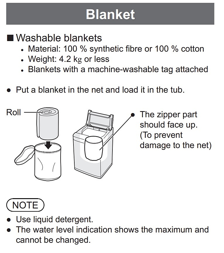

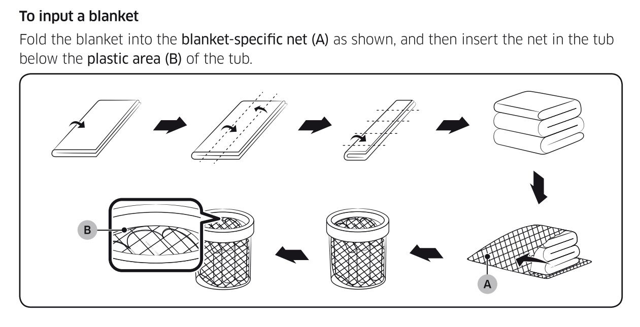

Here is how blankets are to be washed in toploaders by Samsung
and Panasonic
You need a blanket bag or net. Blanket is not to be washed by itself

Make one. Find some fishing net in the market then just wrap it in it.
