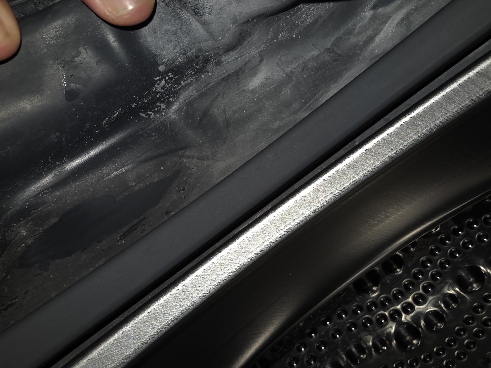

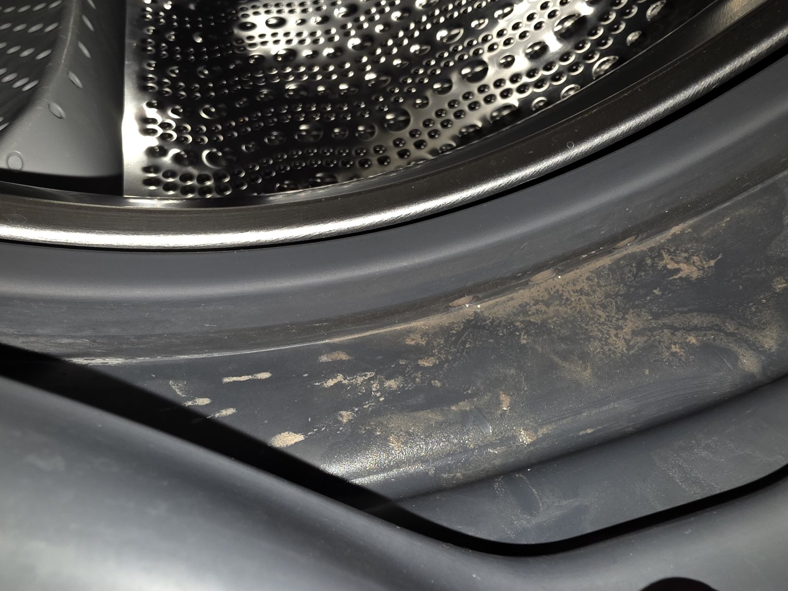

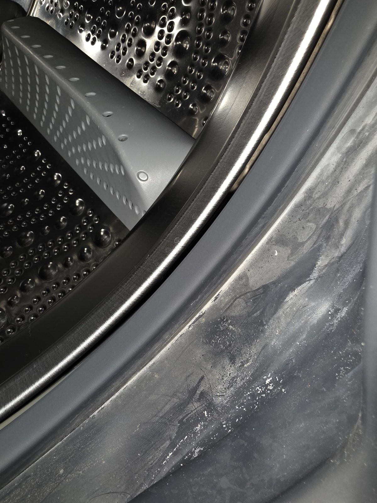

no but only the dirt buildup and it's pretty thick

That's just citric acid. I've explained the difference between a descaler and a cleaner in the opener.
You should wipe the gasket dry after each wash. Mine is spotless after 9 years.
I don't like this black colour Bosch have chosen for the gasket. Seriously what the hell.
Mould is black, how are you to even identify it in this case?
Anyway, you have two options. Either Lizol or Vanish. Pick one, run a 60 degree wash with intense selected. The smell is caused by microorganisms and either will kill them but may require extra cycles.
Soon as the cycle completes and machine is still wet check whether the smell is gone completely, only reduced a little or no difference.
