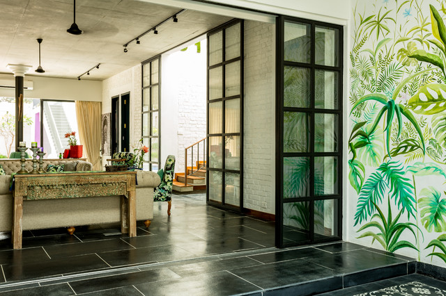

I wasn't suggesting new tiles. We have installed something called as "kadapa kallu" (in Kannada), a rough stone piece. There are small crevices which help with grip.
Reactions: seshu
:p We had similar stone tiles before we switched to current slippery "anti slip, modern" tiles.
Is that in the centre to clean feet? it's a granite slab about 1 foot square
Yes, dual purpose. To clean feet and better grip. We have installed it for the entire floor not just a portion.
