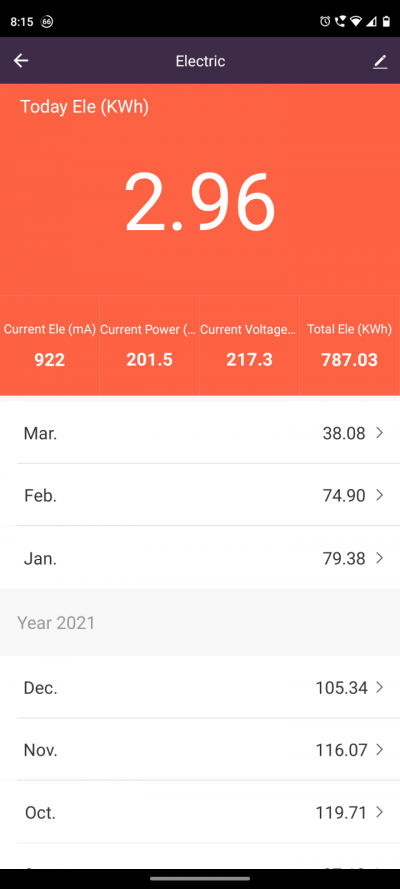

From Oct-Dec when I kept at medium settings, average 4 units/day. During winters Jan-feb, around 2.5 -3 units a day at lowest setting.
That is very high. It should be at most a quarter to third of those figures. What state are your door gaskets in ? soft or hard.

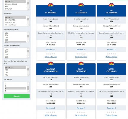

So let's find you some energy efficient candidates
Select frost free from the menu. Don't think you want Direct Cool models.
Then click (select all) in each scroll menu :rolleyes: until you reach the bottom where the star ratings are than go with 4 or 3 and you will get a list
No 5 star models available in any size. These are the 4 star ones
Just six in your size preference. More in the 3 star category
Oh! and 1.5 - 2x whatever figure they quote for per year electricity consumption to get real world consumption.

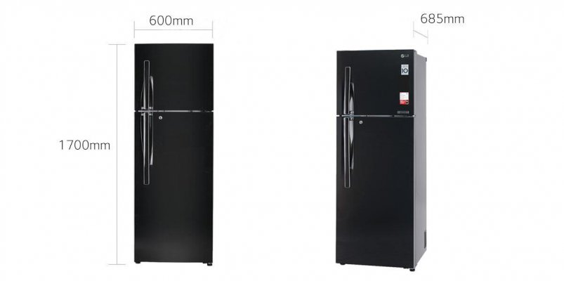

With those dimensions you can fit a 335L fridge.
If you can increase the height from 174 to 178 even the 471L i got will fit. Why do you have a height restriction ?
  • 4 Star Rating List Mar '22.pdf
