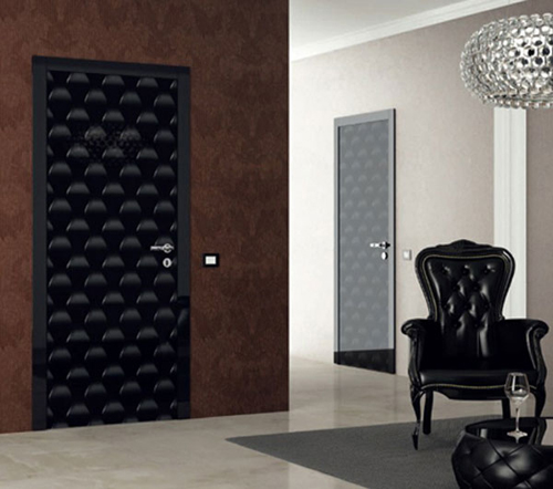

i am going to upholster the door like in the picture below, to let it absorb more sound/vibrations. it'll get spoiled eventually, as i need to do this on a door on a facing outside.
