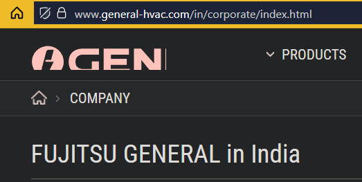

Side note: It's "general" and not "o-general" right? According to the website it seems to be just "General" or "Fujitsu General"
i've got no strong feelings one way or another, but i'm curious as to how you define useless? what criteria are you using? to my understanding, the only difference is power usage and how efficient they are in regulating compressor power draw.
ok, so useless came out a bit strong but in my case it really was but then I'm a weirdo who can't sleep at night with ac running at lower temps without getting sick in the morning, non inverter ACs run at fixed speeds it's either on or off and once the compressor turns off, it'll easily take 4-5 minutes to spin back up while for inverter ACs, it just reduces the speed, so in summers if you set a higher temp, the kon inverter ones would quickly hit those temps and spin down which was a huge PITA because the room used to get hot before the compressor came back on and God forbid if you had electricity cuts. you were guaranteed to not get a good sleep those nights, so basically inverter ACs shine in maintaining temps which is particularly useful for weirdos like me
yeah you are right, it's Fujitsu General but it's always been called O'General and I'm not sure why
