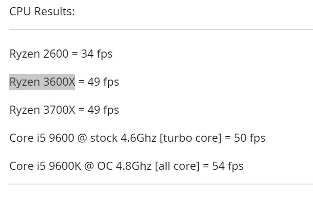

These are the reuslts. I think I should at least get the Ryzen 3600X?
3600X costs about 20-25% more for 5% higher clock speed. You sure about that?
Well, if your friend is gonna do this for you and he knows about this then you don't have to worry about. He will find the best parts for you. :)
Well, on online sites the difference is 3500. I think thats OK. Better than paying MUCH more for an Intel i7 and its motherboard.
