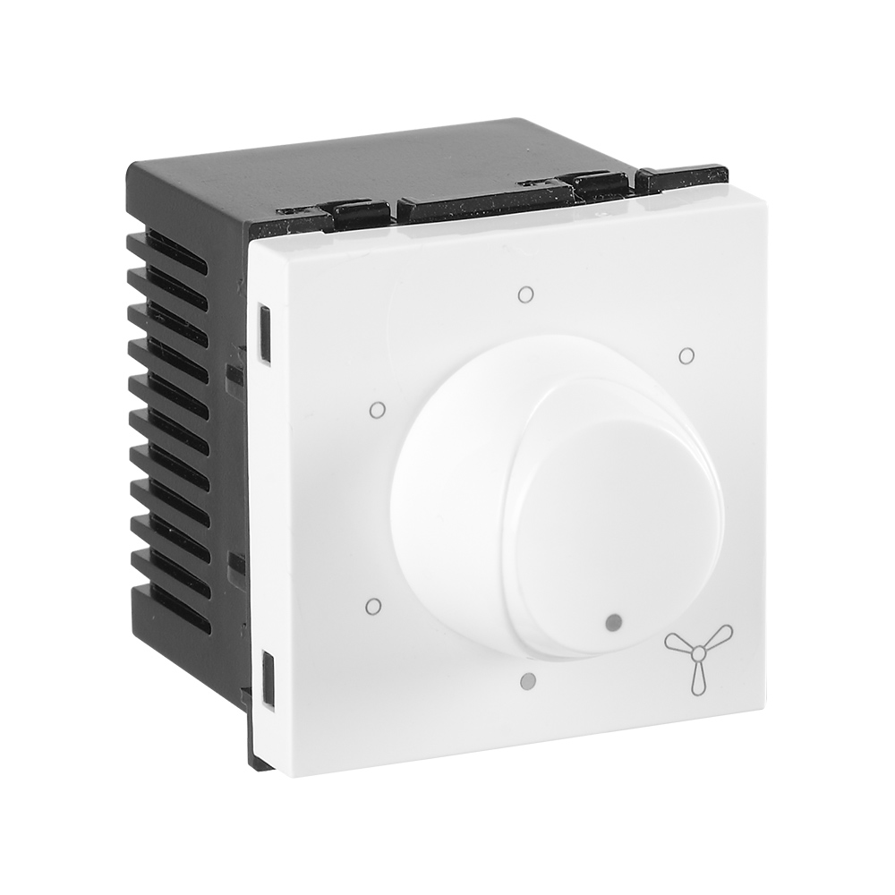

Have an Usha Technoair 1200mm 32W BLDC fan, looking for suitable regulator since I cannot trace the remote (or the fan did not come with remote at all).
Using fans at full speed can damage them quickly, wear and team, other serious issues, etc.
Old block type regulators uses lot of power.
BLDC fans require different kind of efficient regulators and am too looking for correct type, electricians I met are not helpful here.

What's the correct type? You only have fan regulator and dimmer. What else is there?

2M BLDC fan Regulator – switch
I have not seen BLDC specific fan regulators in mainstream switch makers like Anchor, Schneider etc. And we can't just bring a regulator made by crabtree and fit in our board faceplates. We will have to replace all the switches and faceplate for that board.
I have a Schneider fan regulator for my atomberg (model that comes without a remote). The Wattage from the superfan page is correct. It does take 6W on first speed, I have checked that. But the chart also says PF is less than a third. That should mean the fan is using 2W only. The fan whirls so fast on the first speed, so I highly doubt that it's taking only 2Ws.
Yes, there is some confusion on how to select regulator correctly.
Most probably fan is spinning so fast in first speed is because regulator is not appropriate.
USA Technoair 1200mm BLDC fan is rated for 32W, don't know what to do in this case, as without regulator it works in extremely high speed.
If you run a fan without a regulator, it spins at full speed, which is level 5. It's not going to break.
But man, such a high speed at just 6W. BLDC are too efficient.
