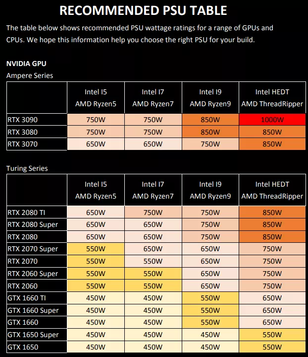

The below is your PSU requirement based on your configuration specified above. Just check it once.
So you dont need PSU not more than 750Watts.
