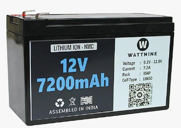

@6pack ,@nRiTeCh & others, how about this LITHIUM ION Battery (Li-ion 12V- 7.2Ah), will it works with APC UPS, just like Lead-Acid Batteries?
Product specifications detail link HERE
it wont work. lithium ion batteries are 14v. even i saw these on amazon and people who got it for ups said it did not work.
Edit: Lithium ion battery needs bms pcb to work and get charged properly. See this.
Reactions: Emperor
