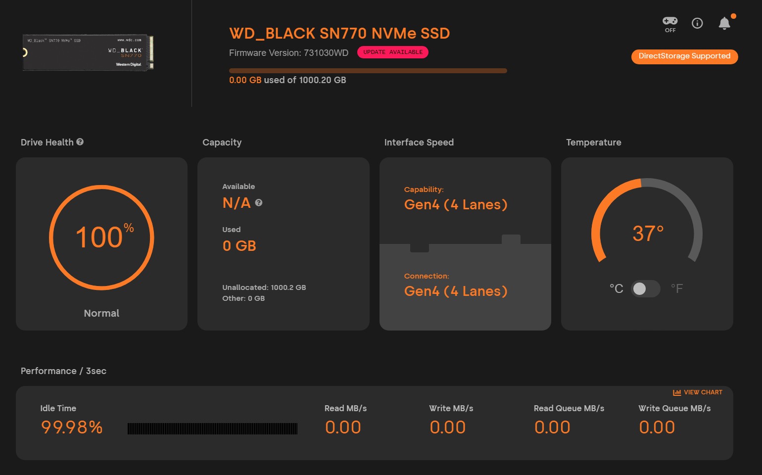

Received the drive in 4 days through Delhivery. It was uninitialized with 0 writes as stated. It was on firmware version 731030WD which I promptly updated.

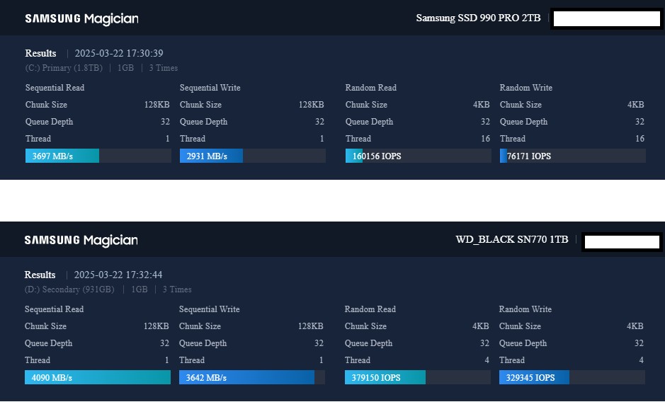

It benchmarks better than my primary 2 TB Samsung 990 Pro drive.
I had transferred about 400 GB from the 990 Pro to the SN770. It is close to 40 degrees when idle and 70 under load, which is okay considering both drives are in a laptop. I had also taken a screenshot of the write performance but deleted it unintentionally. It was about 2500 MBps peak and the cache seemed to give way at around 300 GB, after which the speed was around 410 MBps, which is as expected considering it uses high quality Kioxia BiCS NAND.
Just out of curiosity, how is your 990 Pro benching so low?
Here's mine:
What I believe is that for you @PunkX 75 it is running on a full 4 lanes on PCI Gen4
While his speeds appear to be similar to a Gen3x4 PCI Lane
I'm assuming he's running at full gen 4x4, as well, since the WD screenshot confirms that. Wouldn't the 990 pro be, as well?
or is it that the samsung is running on Gen3 and wd on Gen4 ??
It says that the Samsung is his primary drive, so I'm assuming that the Samsung is also on Gen 4?
If the Samsung is indeed running on Gen 3, then I doubt he would have done an apples-to-apples comparison, because it'll obviously be slower then.
Here's mine:
On the laptop, the PCIe 4x4 bandwidth is certainly getting shared. However, the benchmark was still too low. I couldn't put a finger on it but later in the day, with the extra space, I decided to finally enable over provisioning on the 990 Pro which is when I realised that I had Bitlocker enabled, which is now the case by default for Windows 11 installations.
After disabling Bitlocker, it seems that it has about a 40% overhead, at least on peak performance.
The CrystalDiskMark benchmark is more representative, so the 990 Pro is about 50% faster sequentially and about the same for random data.
