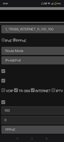

Its done, have to escalate on FB and X, social media team got engaged. They sent an engineer home to just set it up. But they are not that welcoming to share information. I had to ask him for everything username, pass, port no which bridge mode is disabled.
Next i have to setup jio also on home router. Need to configure it on my own Gpon.
Reading to figure out how to go about the same. I have Model no JCO4032, Its RSN is weird starts with RSTO need to figure out how to get the serial no details to get it running.

They logged a ticket to setup Static Ip all engineers were calling for the same. when i said bridge mode they said saar without static IP bridge mode does not work. Post which i did social media escalation and then they sent someone specifically at home to check and set it up. Not sure why they did. Few people called me from backend team and i told them what i wanted. As long as its done it’s ok. 2 days of efforts paid off.

Brdr airtel to enable bridge mode on lan port 4 through email, they called me and said bridge mode is enabled but lan port 4 is not getting power and no light on lan port 4. Internet is also not working. Nothing changed in WAN page. Is port binding necessary while enabling bridge mode ?
Check Port 3, it may be enabled on that. Had gone through similar situation earlier.
