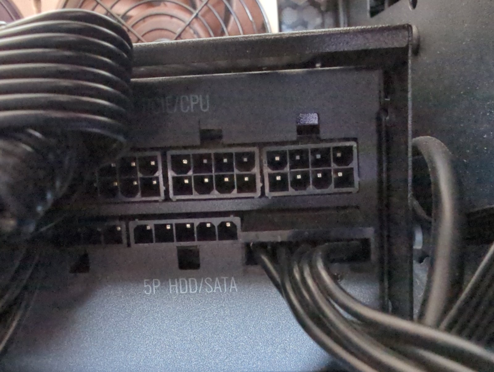

LMAO, i faced similar problems, like the PC will be on, but the Monitor went blank, so i first checked my monitor with a spare PC, and negated the problem is not with the Monitor, then i went for the PORTS in the CARD, could have got burnt, hence i used alternate port available in the CARD, still my monitor went blank, so i found that the PROBLEM is with the GPU, but the strange thing is the CPU doesnt bunk, it was running fine, it confused my problem isolating capabilities, so one fine day i DEDUCED THE PROBLEM could be with SMPS or PSU, but i cant bluntly prove that the PSU is buggy, coz the blank screen begins to happen randomly after 15 minutes of running, i took 2 days to isolate the problem, its not me who found the problem area though, something helped me in a spark of a moment as an EUREKA moment, as my PSU is a MODULAR model, so i looked for multiple modular socket for PCIe Power connector, so i used the alternate MODULE available for PCIE power supply connector, and switched to the adjacent socket available. **TADA, **the problem disappeared after sucha change of socket, it was strange for me too, THUS I FOUND OUT the MODULAR pcie power supply SOCKET is gone burnt KAPUT after 5 years 9 months of usage, fortunately MODULAR PSUs have multiple PCIE Powersupply sockets as a boon helped me to resolve the problem… Hope this solution helps you, otherwise go for the headache RMA process… and get a new psu

in my case, the cable is not faulty its the SOCKET, so i now cellotaped it to identify that the socket is nomore, Yeah, so u have to deduce the bug with the cable as well, in your case 3080FE might have demanded much power, so its possible both the cable and socket could have reached End of Life… its only a trial and error fault finding method, if this doesnt resolve, try it with a spare SMPS, if the problem doesnot appear , then u can pin point the problem is with the SMPS with certainity.

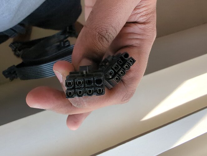

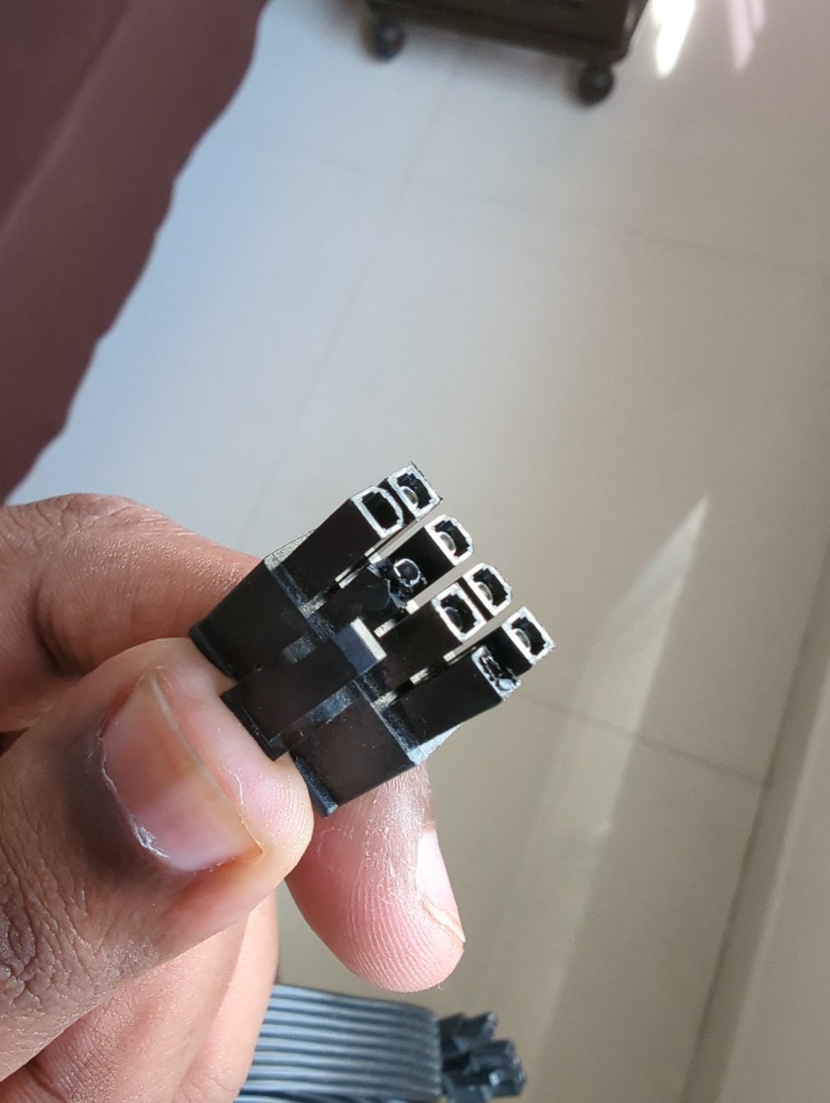

Took off the pcie cable, found this. Definitely signs of melting and excess heat.
Have to deal with Cooler Master support yet again, sigh.

I checked, both PCIe wires are damaged. One of them is melted and the other one has a few discoloured pins.
Getting the wires for this model is difficult.
