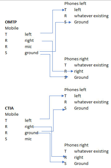

No, It will not work in balanced connection. Though headphone is internally wired for a balanced connection but default cable is single ended (3.5mm TRS) at audio source.
As I can understand you want to try headphones in true balanced mode. We need a balanced out from an amp for it to work in balanced mode (just changing cable or using convertor will not work).
* Single end out from the amp can be used with a convertor or cable to run a balanced headphone.
* Balanced out from the amp should never be used for unbalanced headphones (though some brands do provides convertors but technically it's wrong, may end up destroying the amp).
Mobile phones don't provide balanced audio output, so even if we plug male 3.5 TRRS in some phone it take it as single ended+mic connection and doesn't send both channels signals separately, hence only 1 channel works.
BTW this cable is very good, I guess it's brand name is cablecreations.
My guess is one of the two types, CTIA or OMTP, connection should give you sound on both sides. If we could get to know what type of wiring(CTIA or OMTP) is used in the mobile, it will be easy. Even otherwise, just buy some bear cable & connectors, it will be easy to test it.
But it can never be balanced but at least phones will work fine. I hope I am able to get it across what I am trying to say.
Exactly what I referred to some posts back..
You're absolutely right it can never be balanced. Only manufacturer knows how the wiring is done, so for us it's just buy and try.
