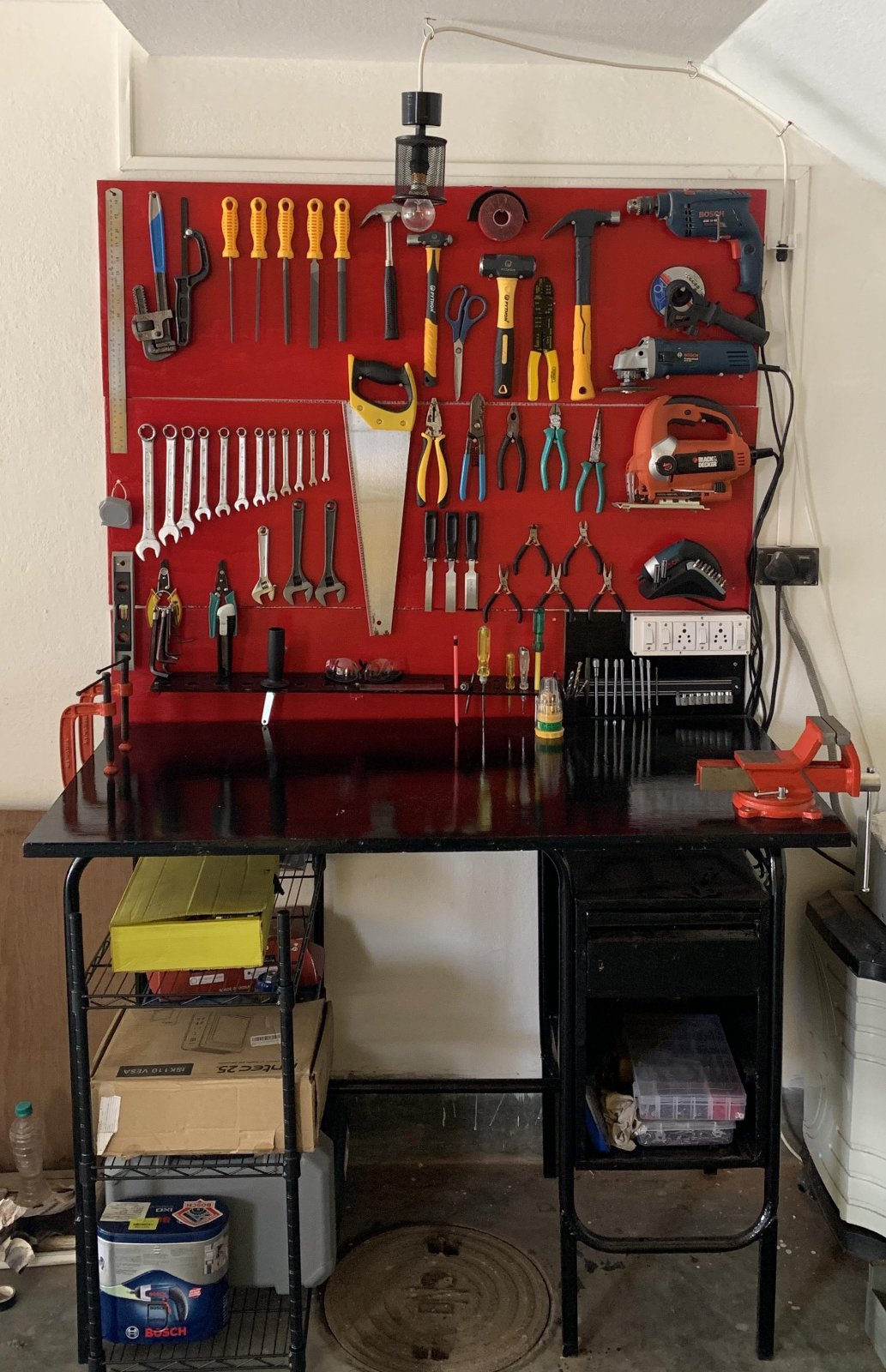

Well, this may be almost on the edge of technology, but I did want to share one of my more 'mechanical' projects that I worked on during the lockdown. I'm pretty sure folks who are into DIY stuff will like something like this.
I'm a big fan of pegboard mounted tools rack as seen in many western countries. I tried my hand with something more basic, like a wood board that act as a shadow board for mounting tools.
It also houses my major power tools:
1. Drill (Bosch GSB 500RE)
2. Angle Grinder (Bosch GWS600)
3. Jigsaw (Black & Decker KS900EX)
4. Rotary Tool (Dremel 4000)
Here is the time lapse of building this tools station.

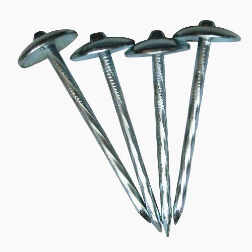

We use these. Seems to be the standard here. Is it unusual?

I haven't seen anyone use these over here in Himachal. We use roofing screws over here, whether the battens are wooden or of iron. I see the same screws being used abroad as well. Was your nail gun even able to take these nails. From what I know one has to fill cartridges in the nail gun, much like a stapler and they come as standard nails and not speciality ones like these.

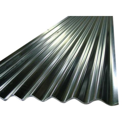

Is your roofing sheet like this?
Exactly. This is the type of sheet I (and very likely @rdst_1 too) was talking about.

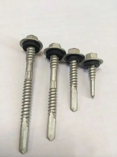

Self drilling screws on the other hand look like this.

Self drilling screws cut down on labour times and is clearly faster. With the L screw you need to drill a hole using a drill bit and if the frame is a square or rectangular tube then the hole needs to come out of the other end and the L screw needs to be inserted by one person from below and the other person on the top will have to tighten the nut it and my guess is that you will chew up atleast couple of drill bits with cutting fluid like machine oil or even more without oil.
Both gets the job done but self drilling will be much faster, if you live in coastal area with occasional cyclone L screw makes sense. Otherwise you will be fine with self drilling screws.
