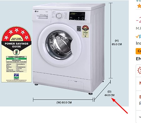

I am also looking to replace my old top loader. Looking for another top loader. Budget is 20k. Anyone using these LG models?
Will it be a lot better if I extend my budget a bit and go for this? https://www.amazon.in/LG-Inverter-Fully-Automatic-Loading-FHM1006SDW/dp/B09LLMH3CQ/
Thanks and could you suggest any model? All LG ones I could find are 44 cm. Only saw a few Samsung models with 55 cm depth.
With front loaders, you have the choice of either Samsung or these LG models
I'd stick to these two brands as the drums are not sealed like they are with Bosch or Siemens. Many Indian influencers pushing Bosch these days I see.
