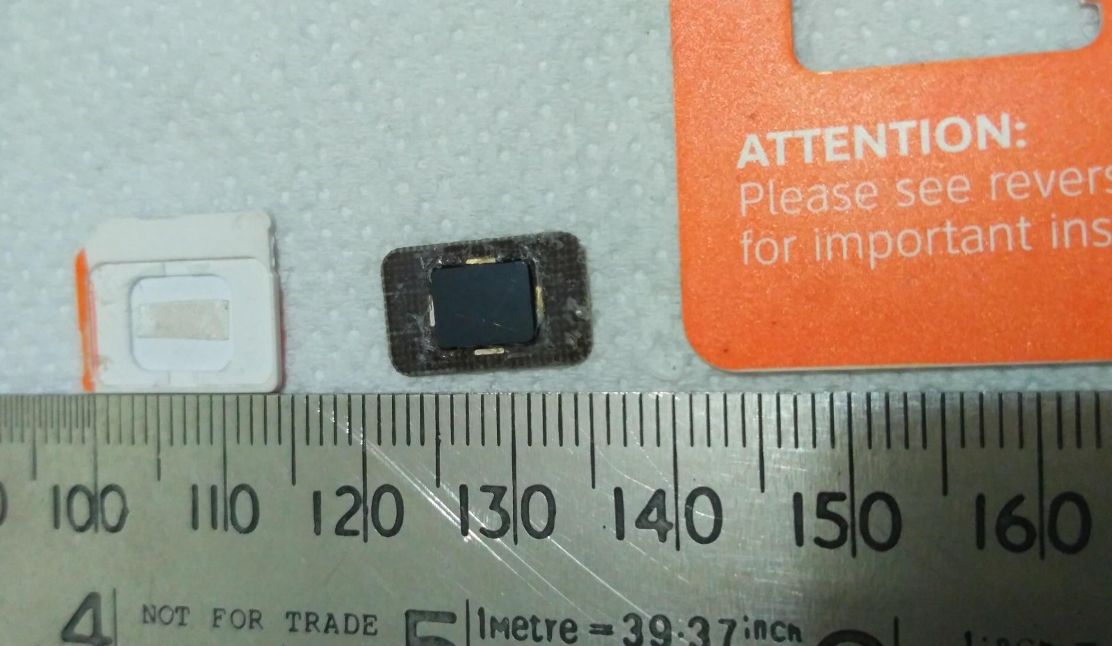

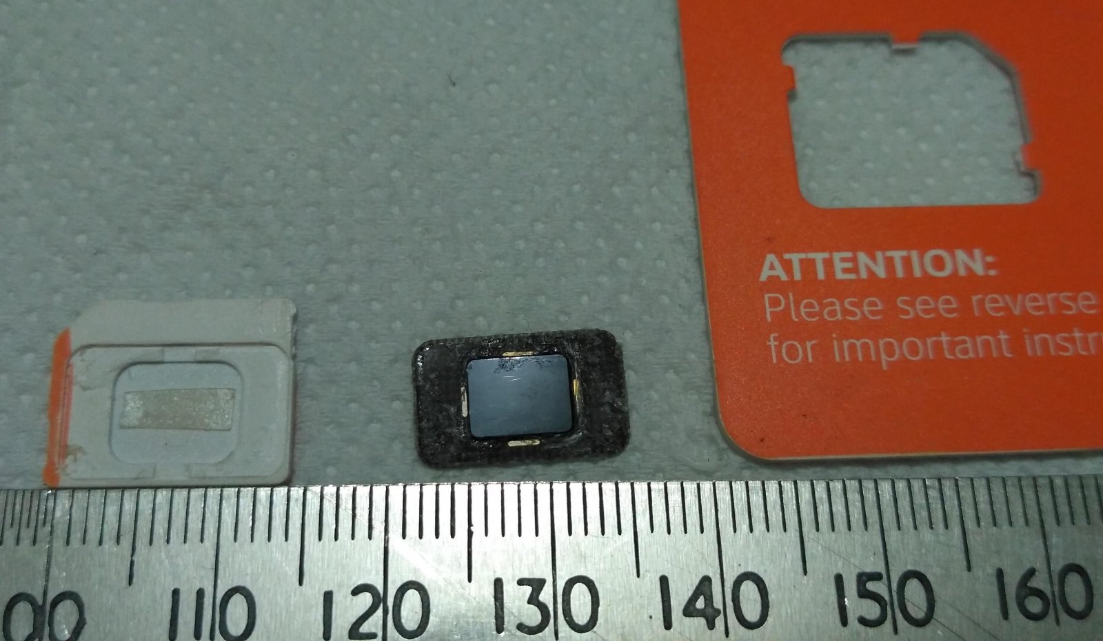

IT WORKS!
Tried it with my Vodafone 4g sim.
So I went with the Acetone method get the SIM card for about 10 to 12 minutes and then using gentle prying with a sharp thin knife, the sim module came apart.
I did not come across any resin so to speak it look more like a chip so I decided not to mess with it. there was a dot on one of the sides of the same card( as you will see in the pics) so I did not do any markings for orientation. I used Araldite klear instead of Feviquick so that give me a little time to position it correctly. After a little drying of 2-3 minutes, I slowly pressed around the sides of the chip on the mettalic parts to give it to lower profile and Viola : I now have two sims and 64GB micro Sd(samsung)[DOUBLEPOST=1476187169][/DOUBLEPOST]See the two bars and storage specs[DOUBLEPOST=1476191895][/DOUBLEPOST]https://imageshack.us/i/poYZLpLQp

update: got the replacement sim from vodafone store and immediately set about opening the old sim. it was the old epoxy mound type, but it measures only 0.41mm thick! if the new sim is also the same it should go in easily without any sanding/grinding/scraping. will be doing it most probably tonight.[DOUBLEPOST=1476454321][/DOUBLEPOST]crappy cellphone camera but check out these detail shots with the bond wires visible.

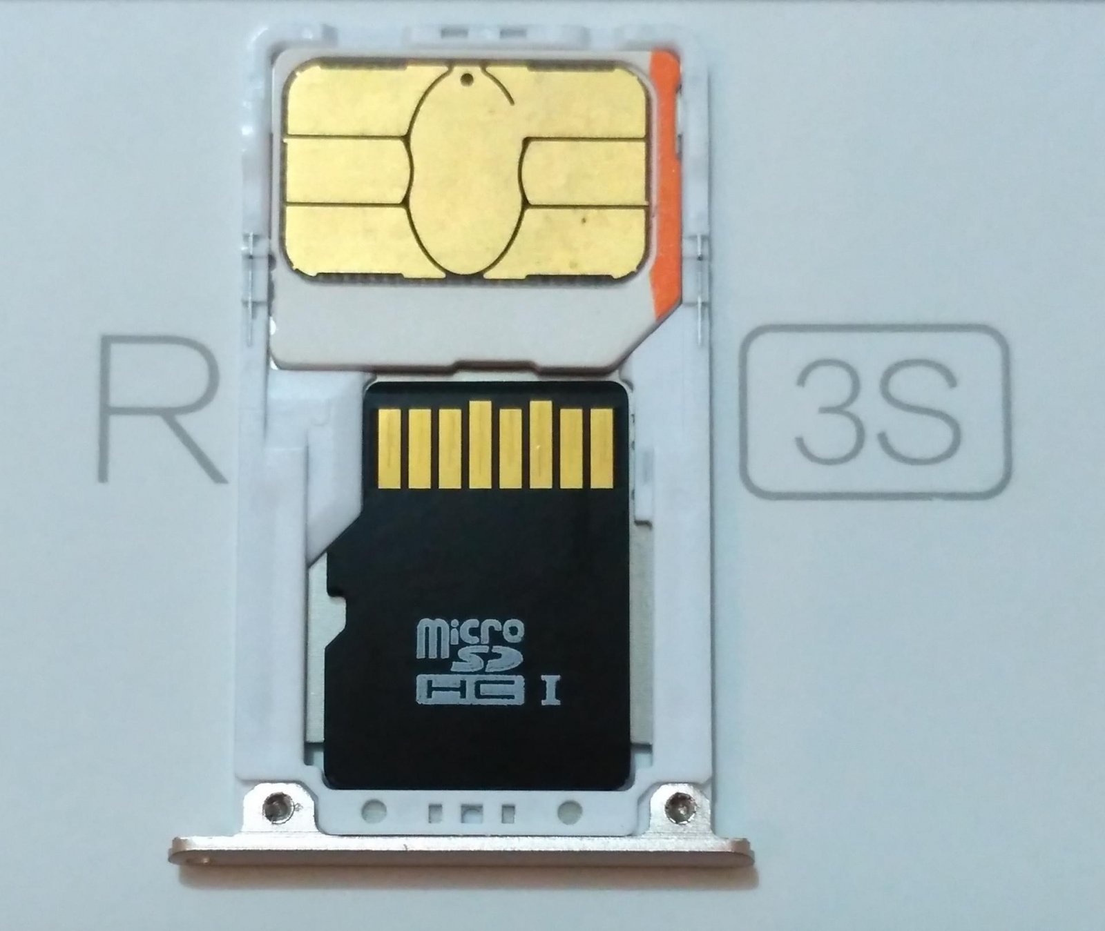

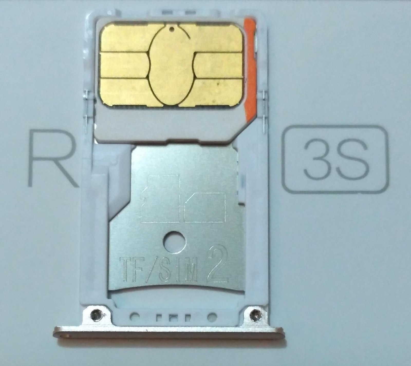

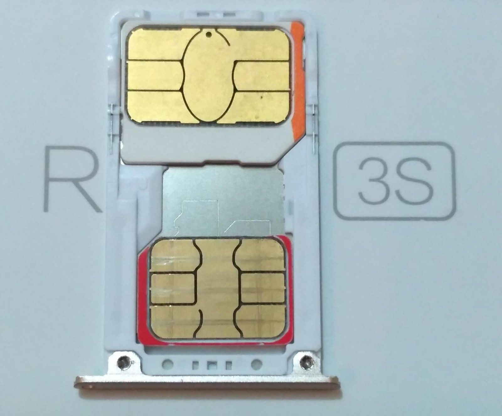

So i'm finally done with the hack. And it's working!
The new sim was just like the one Poga had, not epoxy but the black chip. But it measured only 0.41mm.
At first I tried using double sided tape to stick the edges to the microsd as a removable way, but it wasn't secure enough. Then tried a small line of feviquick in the center of the chip but it wouldn't stick. It dried on to the microsd but there was nothing on the chip. I had to scrape off the dried feviquick since it was now increasing the thickness by 0.02mm. Next i used a tiny bit of imported superglue gel that i had and it finally stuck well. Total thickness using the 0.74mm PNY card was 1.16mm. But it was still an uncomfortably tight fit. Dunno how 1.2mm would even go in.
Also realised it would have been easier to bend the leading edge of the sim contacts downwards into a chamfer BEFORE supergluing it to the microsd. The main issue is the sim reader contact pins on the pcb are perpendicular to the usual direction sims are supposed to be inserted. Meaning the Mi phone sim trays insert the sims 90° from the way they should be inserted. So if the edge of the sim is not sloping downwards and it catches the edge of the sim reader pins, with too much force, they will bend out of position.
Everything is working so far, in the process of updating to miui8. More later...

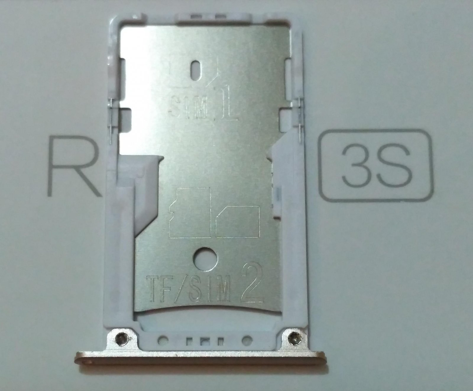

How easy was to insert the sim tray after the hack, is it tight? I'm still not able to do it with my Jio Sim, I got the sim and microsd card but it doesn't, Don't have a vernier to measure. wish you were staying in my city
It's quite tight. Even removing the tray is not easy at all. You have to use quite a bit of force on the pin to make the tray pop out. And after that you still need to pull rather hard. As i said, this is 1.16mm, can't imagine 1.2.
The biggest problem is the sim reader pins are perpendicular to the sim insertion direction, not parallel. So if the sim is too high above the tray, it will bend the pins. It would have been much less risky if it was in a proper orientation.

...i used a tiny bit of imported superglue gel that i had and it finally stuck well...
Lol now i'm wondering what if my sim dies, or for whatever reason i need to separate the sim and microsd. This superglue has stuck TOO well. Should have used a softer adhesive maybe, but most of the rubber based ones are solvent based and could damage either surface. Maybe plain old fevicol is a good option.
