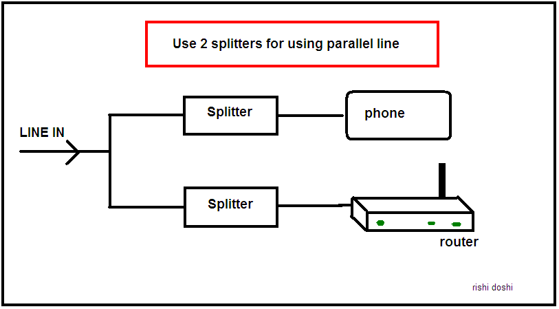

One more thing to look out for is parallel lines... read the previous posts in this thread for more info...

ALSO, using the below wiring and using 2 splitters i can get the mtnl BB to work in parallel. I cant guarantee this for everyone.

Dinjo have you tried getting 2 new splitters and trying as per the diagram above? It should work for most people, unless it is a wiring problem elsewhere.

I am having direct line into the splitter from their to modem and one land-line instrument that's all.
