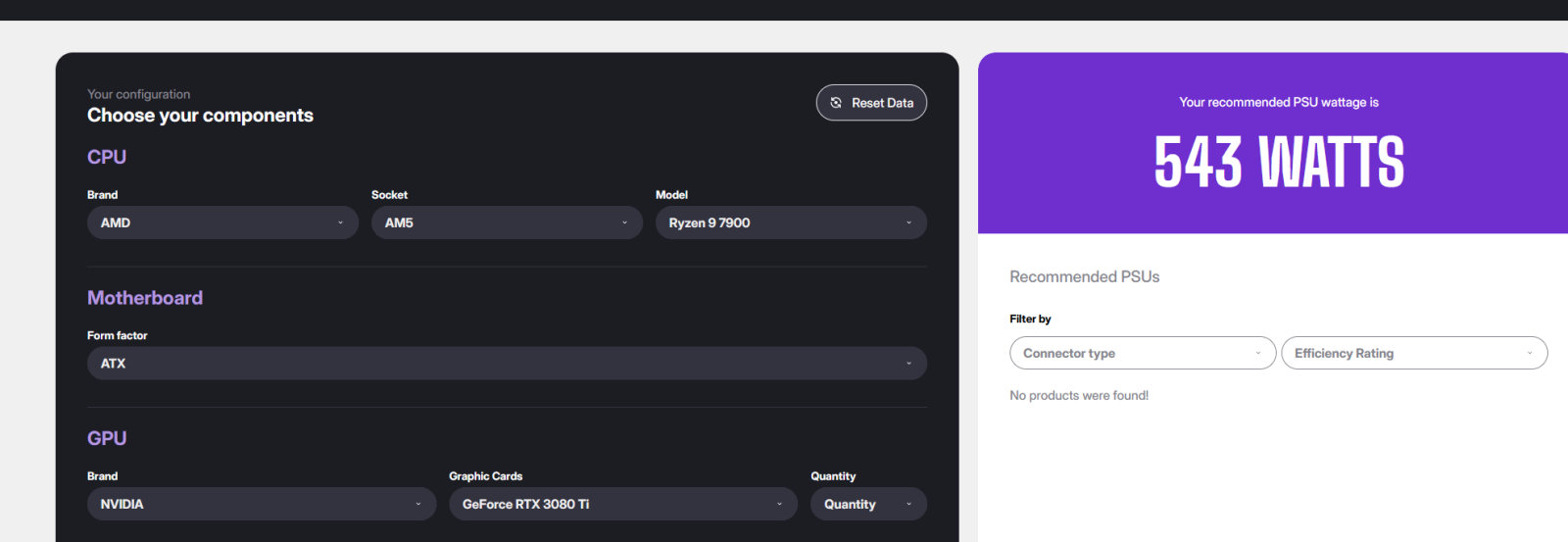

Is this a reliable website? PSU is much cheaper here.
These calculators aren't exactly accurate but will give you a rough idea of how much of a waste 1000W will be.
I had run a calculator but now realise that I had run it with the 9900x and the 9800x3d. :facepalm:
Edit: It still shows 900w

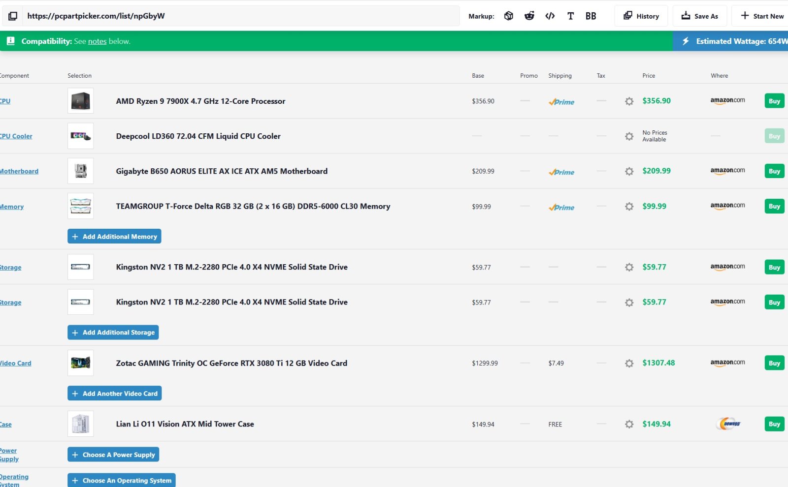

Newegg shows 900 watts and PCPartpicker shows 654 watts. This is nuts.
MSI is showing 900 and Bequiet is showing 814w.
In what you have shown as 543 watts, you have not added RAM, storage and cooler. Maybe thats the difference?

I will have to disagree with the requirement. There is ZERO chance a 1000w will be required for running the above configuration. These calculators always add more than what actually is required (most of them). Even given the benefit of doubt, remember, that these figures show SUSTAINED and CONSTANT load from the wall, with everything running at 100% at full power at the same time, which is a very unrealistic scenario, for the most part. OP, there are several videos that you can refer to regarding actual PSU requirements under similar conditions. The rest is your call
RAM, storage, and cooler will never add even 100w, let alone 300w extra. As I said, these calculators are known to overdo wattage by a gross margin at times, to push advertisements of their higher wattage, higher priced units.
