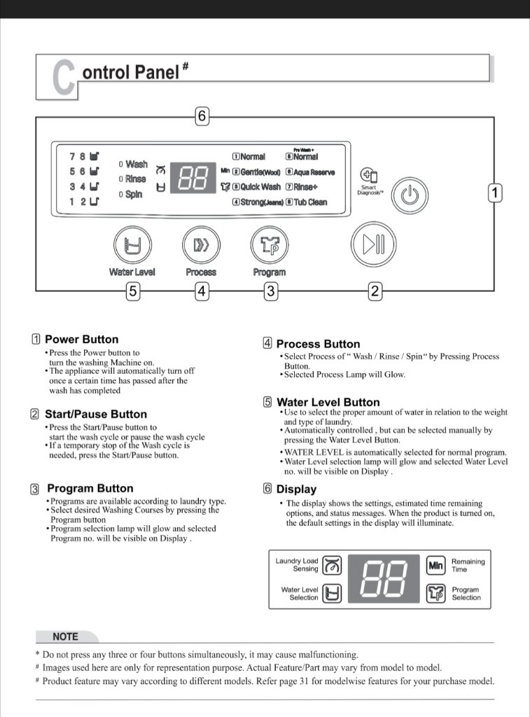

Hi @6pack - I can understand your frustrations with trying to figure out the Control Panel & Timing Indicators on your LG WM
I have a lot older model of an LG Direct Drive WM & how I manage the control panels is what I can share
1. Check the Manual for correct programming of the steps.
2. IGNORE ANY REALTIME indicators - esp of TIMINGS
[initial timings by the WM is calculated on basis of First WATER LEVEL SELECTED; then on Wash + Rinse + Spin Cycles - and Finally ON - Actual weight of the clothes & the Water Level (Once filled up before the REAL THING STARTS ........ So Ignore Timings in this entire process)]
3. I am able to PAUSE at anytime - Open the Lid & Add anything else - then press START/PAUSE again [but I do not bother about TIMINGS...... my LG WM then resumes it's wash program .... even if may re-calculate timings ..... which I do not bother about anymore] - because end of the day - KAAM HONA CHAHIYE .... BAS :D
If possible - send a snapshot of your Control Panel here.
This is mine below

Directly from their manual

The Random Beeping Sounds are NORMAL - Its when the LG WM is re-calculating - the remaining TIMINGS & WASH CYCLE PROGRAMS - even as it refills water or completes a current cycle and proceeds to the next :)
BTW - You Can Put the Washing Powder/Detergent - DIRECTLY in Your Drum
The small tray is just a gimmick & you may see at the end - that some detergent residues are left behind :p

I think I figured out the problem. Don't open the door to pause it. First press the pause button then open the door, do whatever, close the door. Then hit play after.
Yup, tried this way and it works like intended.
